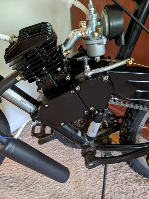

Can you post some pictures?

@Greg58 Even manually moving the handle i cannot decompress the spring, so i cant adjust the flowernut at all. @Venice Motor Bikes will try and get some pictures @Mossy I would take the whole thing apart, but I'm not a very good mechanic lol. I took the side cover off and tried some stuff, but people say to remove the flowernut, which i cannot do. I'm assuming something is really stuck in there, and im currently just trying to get it to work lol. So basically when I move the handle manually nothing happens. It gets stiff, and then i cant move it any further but the clutch part with the flowernut (plate?) dosent move at all.

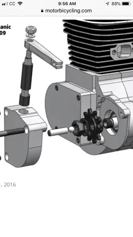

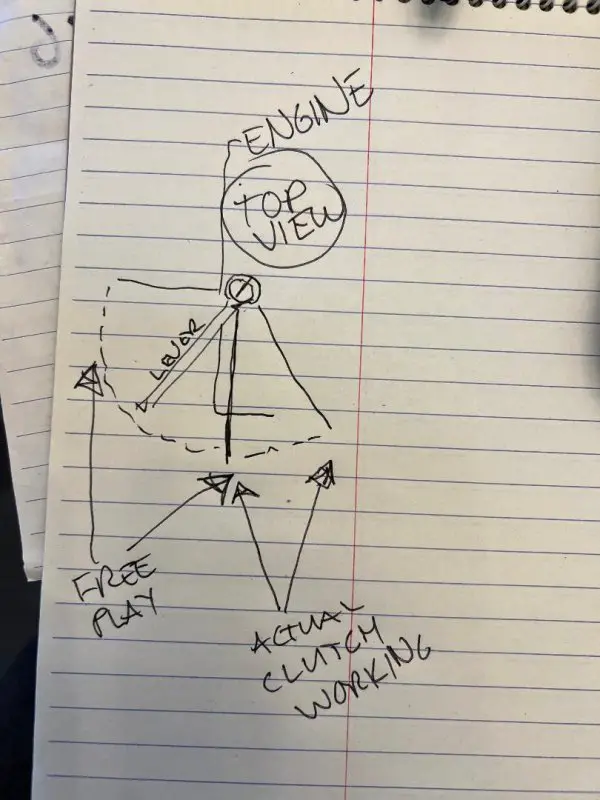

Here's a little diagram of the engine clutch lever... The lever has a lot of free play until it points almost straight backwards...
Using your hand, push the lever hard towards the center of the bike; It should move the plate on the opposite side of the engine outwards.
Report back what happens
Yes, that's about what my lever looks like. Do appreciate the drawing as well. When I manually pull it in (or would it be push it in) ALL THE WAY the clutch plate (i have the right side open) doesn't move at all. And yes even pushing really hard (probably too hard lol) nothing

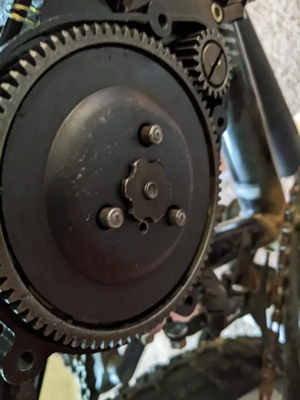

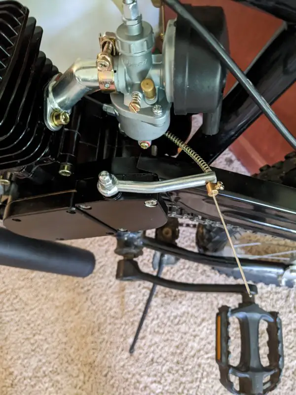

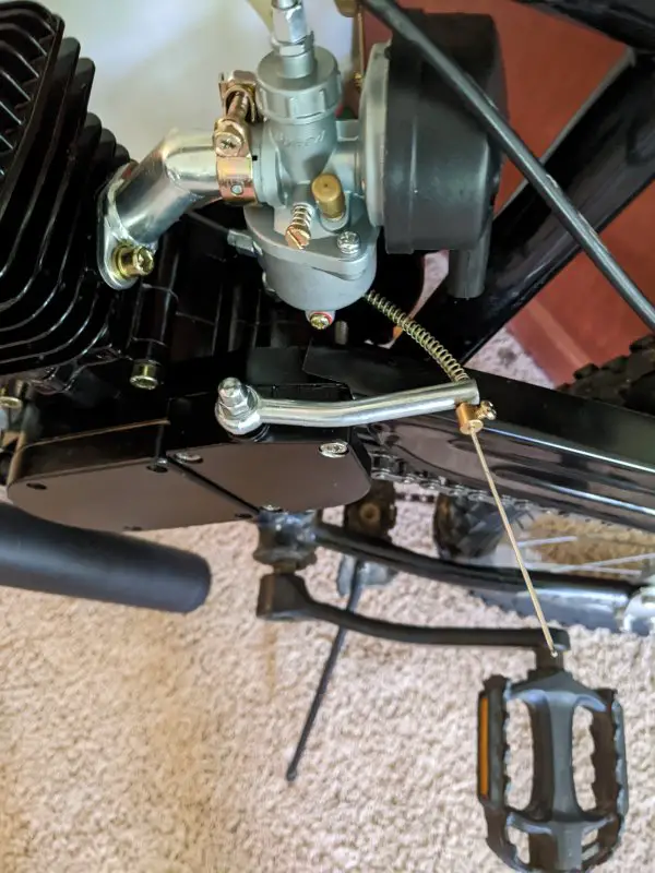

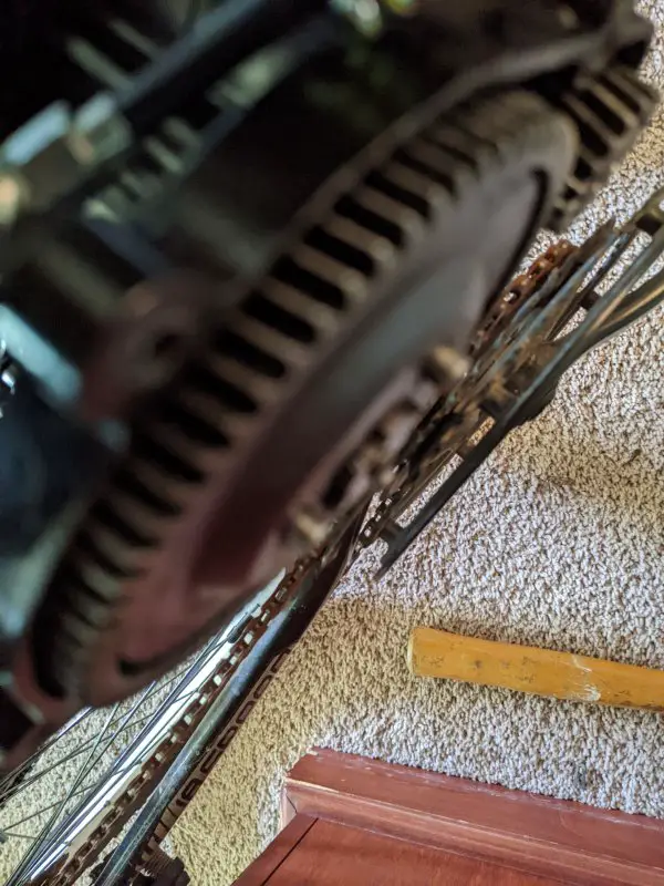

Painted engines have been known to have paint over spray on the piston... And you flower lock bolt is missing... Looks to be turned in quit a bit... I'd back it off some but you're still going to need that time screw
Now what do i do though lol. Get a new screw? i cant really turn it AT ALL
Use a flat end punch and a hammer and turn it CCW, it's under pressure from the large internal spring. I would turn it 1/2 a round at a time till it will release when you push the clutch arm by hand, you'll need to adjust the cable after turning the flower nut also.
So you didn't take the small screw out? You can find one at a hardware store. You'll need one to keep the flower nut from backing off after you get it adjusted.
