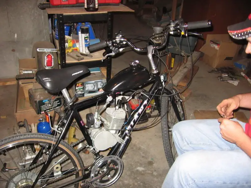

well, my project hit a few snags last night
the bottom tube on the Giant is far too wide to mount the engine without substantial modifications witch we found out after the rear sprocket was assembled at about 11:00 pm
so with a couple quick calls to friends looking for suitable donor bikes I was able to trade my friend Chris a beer and a chance to ride it when it was done for a complete 1960s or 1970s Columbia in working order
by 2:00 am we called it a night but we have
the sprocket mounted
engine in
controls on
cdi on
wiring done
tank on
I have to shim the rear tire because we are having some rubbing issues chain to frame wise
I have to grab a chain break and some fuel today
and with any luck I will have some youtube videos up

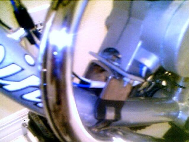

Interesting, verrrry interesting. What kind of muffler clamp is that? My picture is a little fuzzy but I like the way the mount "stands off" from the frame. I'm not a big fan of drilling the frame for motor mounts.(c)Walter F.

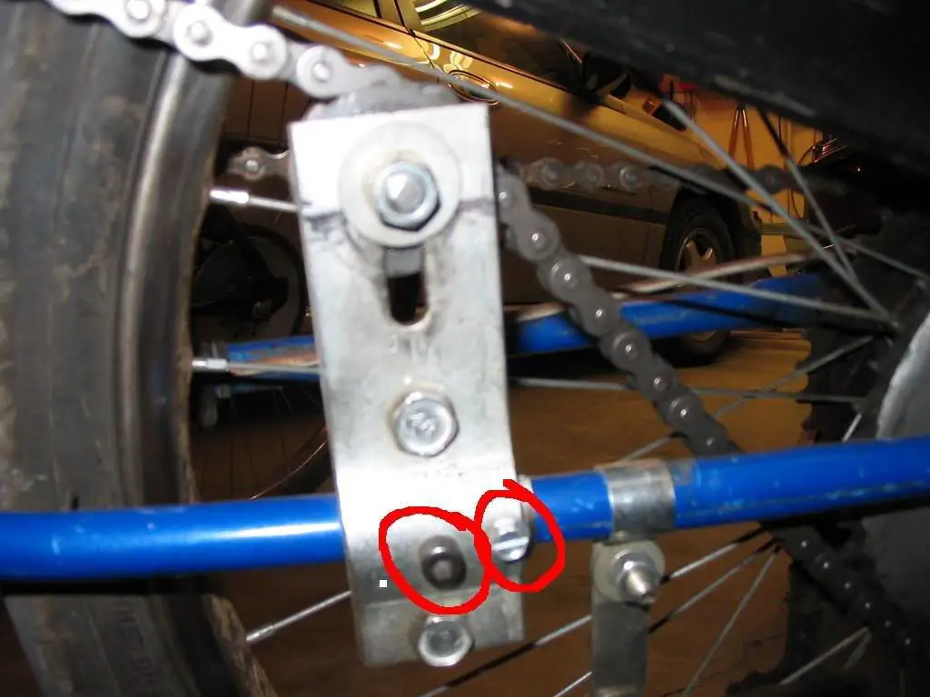

we got the bike running today I took about 3/4 of a mile on it to shake out any bugs, then my buddy who has been giving me a hand on the project took it out I have a video of him going passed the house on it.... about 5 seconds after I stopped taping I watched the rear end of the bike trying to get out from underneath rick (my friend) and then I heard a sliding noise, and then a POP and then the bike stopped moving., sensing that some thing MIGHT have failed I decided to go take a walk and look at the damage.
the chain tensioner slide and drove the chain off the rear sprocket twords the rim the chain got cought between the sprocket and the spokes locking the back tire destroying the rim/tire/tube.... oh well nobody got hurt so its off to the bike shop to see about a good used rim assembly when we stumbled across another free bike this one looks very road worthy so we chainged all the components over and will be testing tomorrow
http://motorbicycling.com/f3/chain-tension-help-99.html
Notice the screw and bolt that go threw the frame ( In red ) Norman used both but you could fust use a bolt or small sheet metal screw...This will keep the tensioner from going into the wheel and spoke's. Link for the thread is above.
Oppss, sorry :( that is not the pic of the muffler clamp....that is a tower standoff clamp...I've seen them at RadioShack I think..
I drilled my frame, going on year five and over 4,000 miles and have had no problems....
Here are some exsamples that I have found...it's the kinda like the clamp you would use for your old TV attenna on your roof.

Day 3 went Very well
we bolted through the frame for the tensioner and replaced the hardware with grade 8s
everything is on and we ran it for about 20 miles yesterday stopping to make sure nothing was falling off, and she is still tight. so I took it to work today (about 6 miles) and she ran perfectly, it started to rain half way here but I had the foresight to bring another set of clothes, so far I have had four of my neighbors stop buy and show currosity about building or having me build them one, I have sent them to the guy I purchased the kit from and to this site

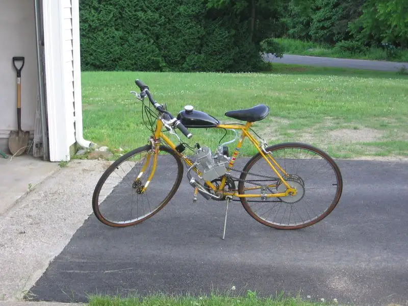

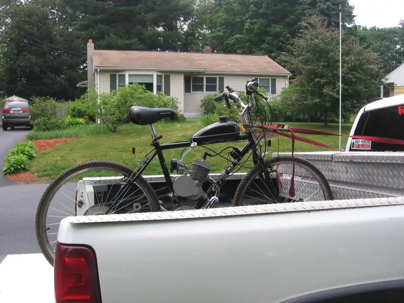

well I promised Pictures
"Rev B"
"Rev C"
after I make sure it isn't going to rattle itself to pieces I will start with the customization

I keep saying this over and over but if it is possible remove the tensioner and adjust the rear wheel for the motor side chain. If necessary move the tensioner to the bike side chain much less pressure on it there. I heard it before I built my first one and then I finally did it after I wrecked a wheel and the darn chain still would not stay on. I haven't had a bit of trouble since.
