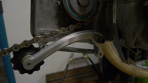

    I like to go on long rides, 100-200 miles per day and I hate having to stop and adjust my chain tension. For that reason I love spring-loaded tensioners. However, my setup uses a centrifugal clutch. For bikes that have a manual clutch (and can thus engine-brake) when the load on the chain gets reversed as during engine-braking, the bottom side of the chain will be under tension and the top side will go slack. because there's no tensioner to take up slack on the top, you can risk throwing a chain when engine braking.
    Here's a pic of one I just made for use on a Staton gearbox driving a freewheel crank:
    [​IMG]

    The ones I used were salvaged from hacked bikes and were nearly new. Made some small brackets from pieces of steel , couple tacks with welder and was complete. On one, had to put it upside down and position it so it would follow the chain. Yours appears to be much heaver duty than mine but then I was not engine driven. fun stuff huh.
