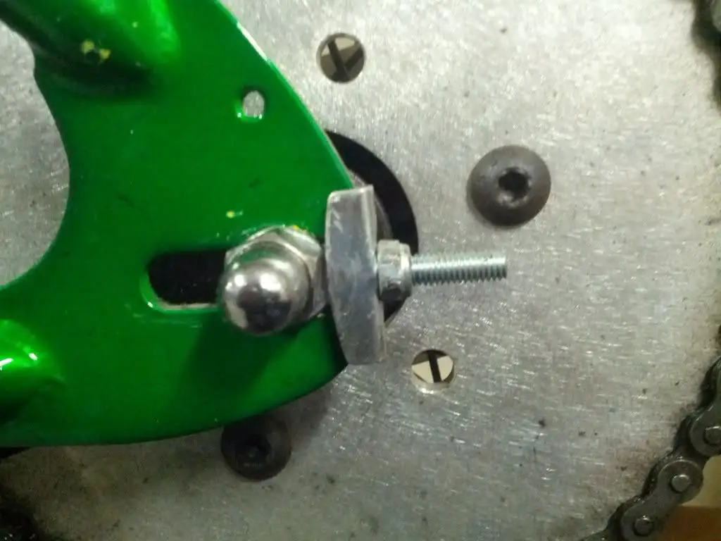

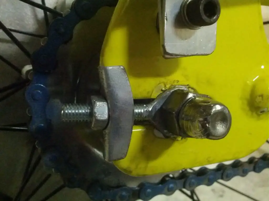

Any one tried one of these chain tensioner that mount to the clutch cover?
I just can't get the crappy one that comes with thte kit to sit right. It keeps drifting in and the chain rubs my wheel.

It's stupid, the stock tensioner. I have some wire that keeps the bolt from sliding in, and it connects to the frame.
Try that first, might save you a few bucks :)

As far as the crap tensioner goes, weld it then twist it slightly so the roller lines up with the chain...thats what I did and have had no issues since...

I just drilled a hole straight through the frame and stock one and just put a bolt through it and it stays in place.
I see you have a Genesis Two Nine. The chainstays on this frame are rectangular, and I found it a perfect compliment to the stock-idler. It naturally stays vertical without slip.
