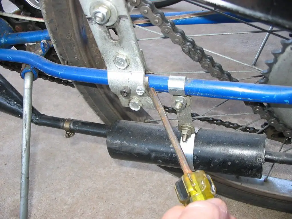

Here is the mods I do to the chain tensioner.

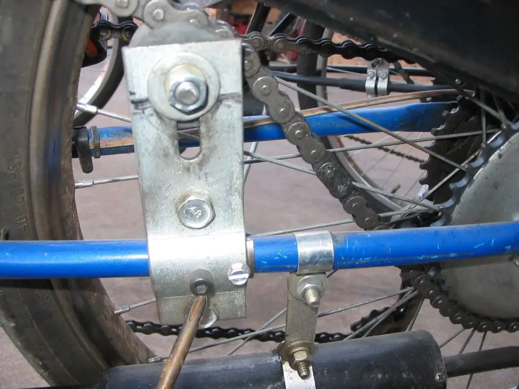

Here is the screwdriver pointing to the sockethead set screw it taped and drilled to hold the tensioner form rotating you will notice I also have a sheet metal screw holding it as well it was used to hold the metal shimms in place.I decided to try both at once and now I don't know why?! the bolt does not go all the way through. threads are taped in the bikes frame and I think its fine threads 1/4-28
in this you can see the metal shims a little better

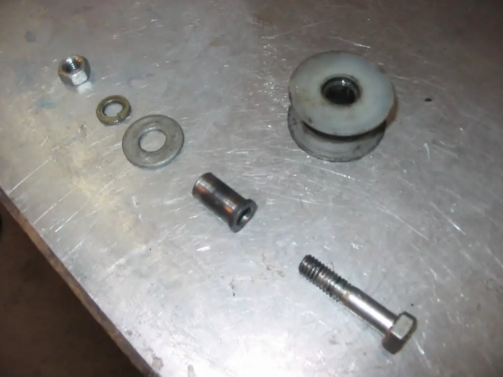

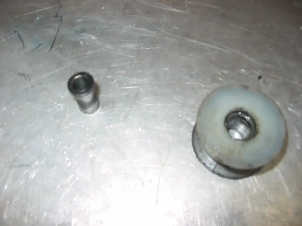

Here is the mods to the bolt that hold the idler wheel in place. I drill out the bolt and use a better american bolt the cheap china idle bolt becomes a bushing and when I tighten it down it will not slip anymore but you need a lathe to drill out the bolt at least I did to get it right.
the old bolt converted into the bushing with the usa bolt. 1/2 head I think its a 5/16" dia.

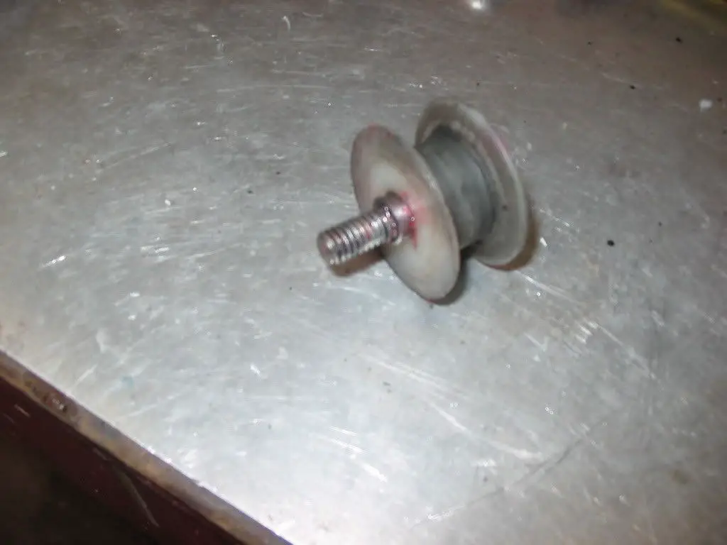

greased and ready to put on the bike

I tapped a #10-32 threads through the tensioner and installed a socket head bolt before I even saw this post. You know what they say about great minds!
