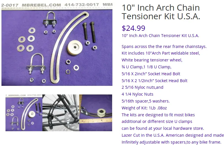

I tried a lot of the different chain tensioners and even built one of my own. I don't like the idea of clamping to the lower tube
on the bike. I've had better luck with "Arch Chain Tensioner" since they help support two of the back tubes on the bike.
GasBike, Kings Motorized Bikes and MBRebel has them along with a few dealers posted on the Forum. Here's what
they look like off of MBRebel's site:
