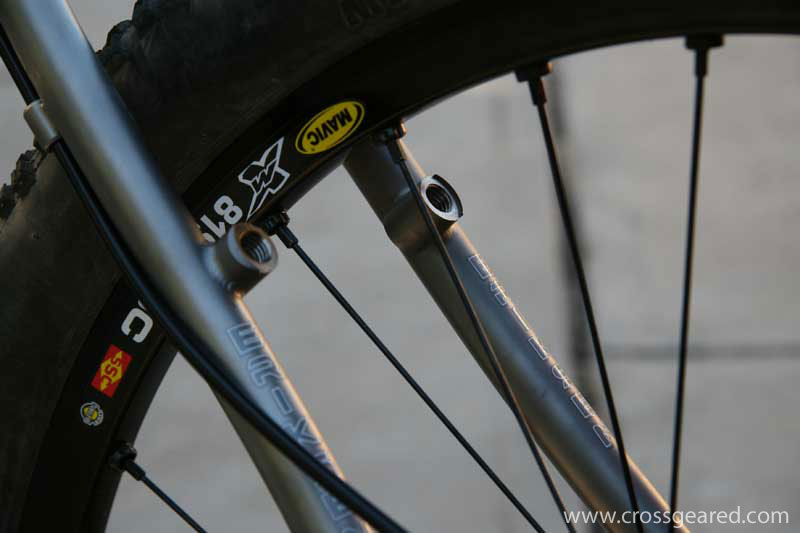

saw some of your other posts about not being able to get brakes on your bike because of the double set of bosses. Brake bosses generally unscrew, and the intention of the frame was to unscrew the set of bosses you arent using. I think this will work. Sorry if you already figured this out. Heres a picture to demonstrate.
Moto, I really appreciate the help for sure! Yep, I did know the hollow threaded studs screw out of the boss. I figured that out on my first build out of pure curiosity. The problem is the permanent welded on raised stud boss for the upper level brake location on the new GT2A frame is in the way of the lower one for 26 inch wheels. It has 4 raised welded on brake bosses. If someone build a brake arm with the pad on the opposite side of the arm it would work also, but I doubt they exist. One would have to grind off the welded section which I would be ok to do but matching the paint is a problem since I purchased it already painted. I'm building a vintage look show and go bike so a huge ground down wart would be not be an option until I can figure out the color. It looks like a 09 VTX Honda metallic yellow color, but cant be sure yet till I get some ordered from NAPA. Point is... its kind of odd for the factory to weld and install something and then paint something that can be used by nobody and I mean nobody with out grinding off the upper boss. I would have no problem if the people selling this frame stated that that's what you need to do in order to add 26 inch cantilever brakes, just is annoying for sure. I'm going to just go with the coaster brake and later this spring have a drum brake for the front laced into my front wheel as a Disc brake would look out of place in this vintage look bike that I'm building, trying anyhow///lol
