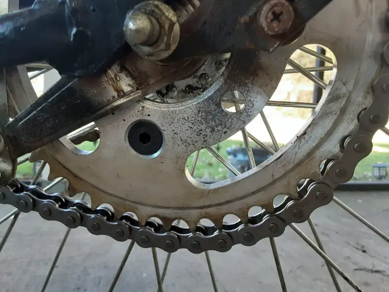

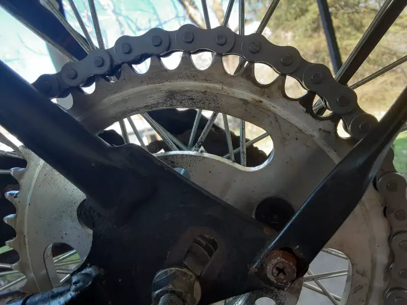

i got my 2 new chains in today from gas bike to make a long story short they say those 415 chains fit that cnc sprocket i got from them.....i let you all be the judge of this no matter what i do it wont line up with the teeth.
In ANSI spec a chain number that starts with a "4" should be a half inch between pins. The 4 designating 4 eights of a inch. 5xx chain is 5/8" etc.
What's the distance between the pins?
Yep. Same sprocket and adapter as I got from BikeBerry. Same problem too, but mine isn't that bad. Nice looking pieces though. They're P'sOS but they look nice. I can't get the master link in if the 2 chain ends are on the sprocket.
