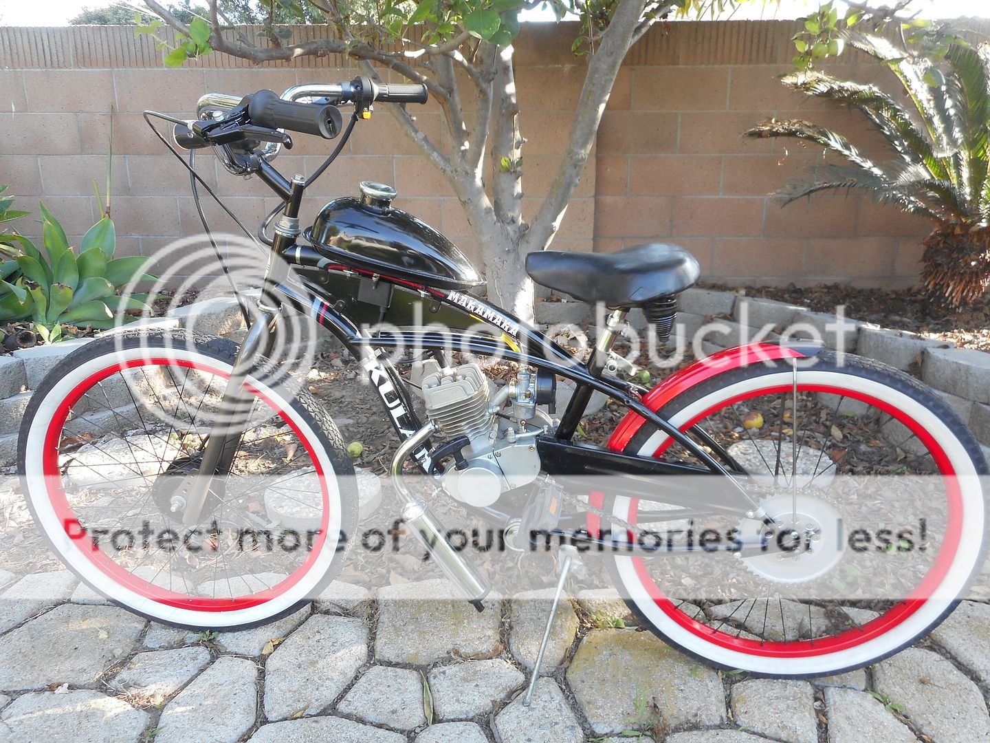

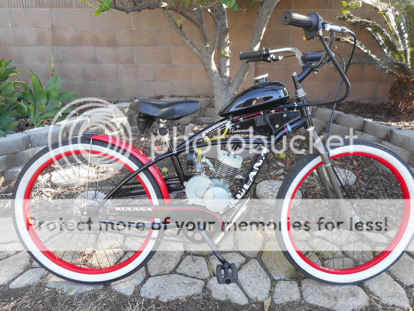

I just built a bike with a kit I've had for a few years and it had a centrifugal clutch and pull start. Mine came already installed in the motor and it does have a sprag bearing built into it. So you retain the manual clutch so you can lock it to push the bike around or pedal start. After replacing the junk pull rope with a quality one, it works great. I don't even pedal start anymore. Just have the manual clutch lever locked and pull start the motor, let it warm up and let the manual clutch out. It idles nicely until you gas it and take off using the auto clutch. I'm very satisfied with the way it works.
