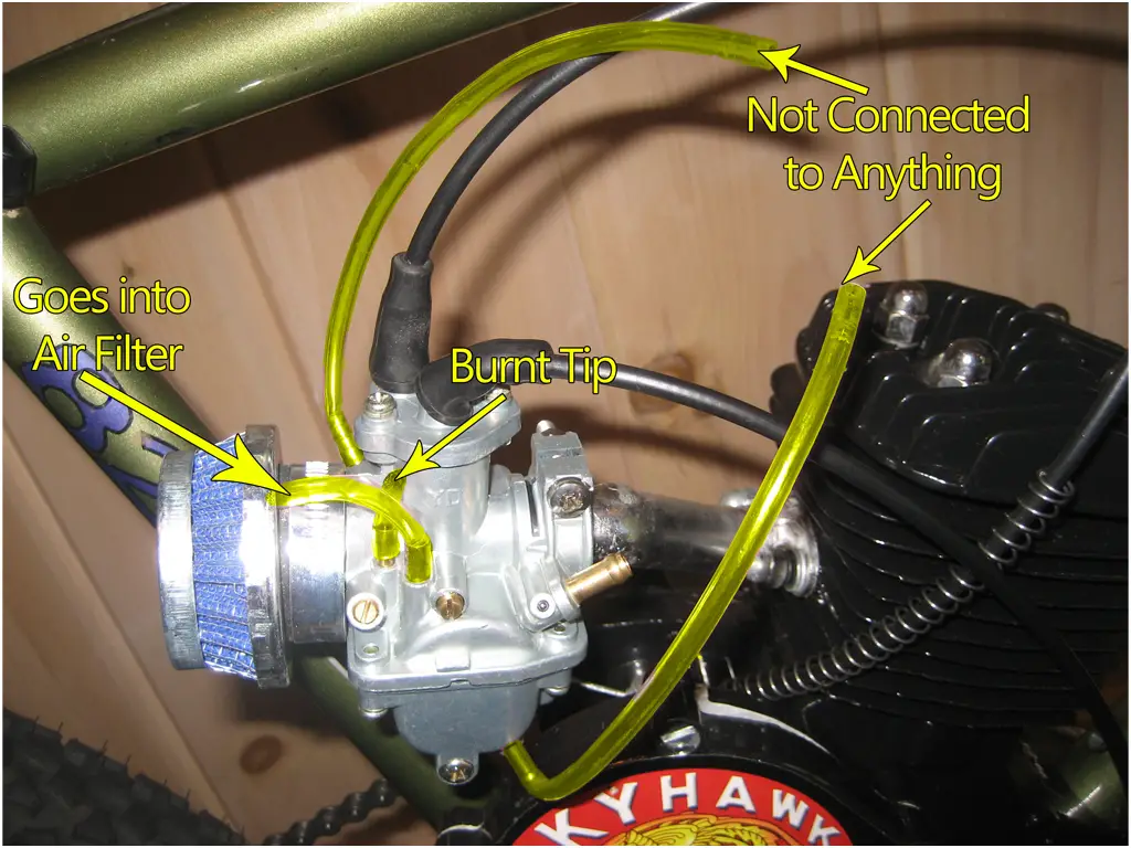

As you can see in the picture, there are 2 pink tubes (highlighted in yellow) that are attatched to nothing. A third seems to be burnt about 1cm from the connecting carb nozzle and a fourth runs from another carb nozzle into the air filter. This is how it was shipped to me (from bikeberry.com)
How do I properly assemble the carburetor?

Looks like vent hoses except for the fuel inlet. Drop the bowl and you will see where they go. Typical emissions compliant carb.
