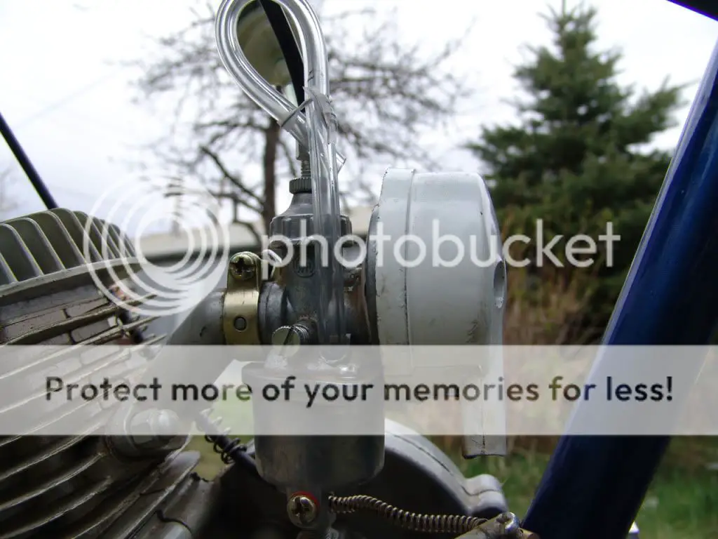

RTV...now to let it dry over night.
Everything's all good. I managed not to get any sealant in the bowl!
