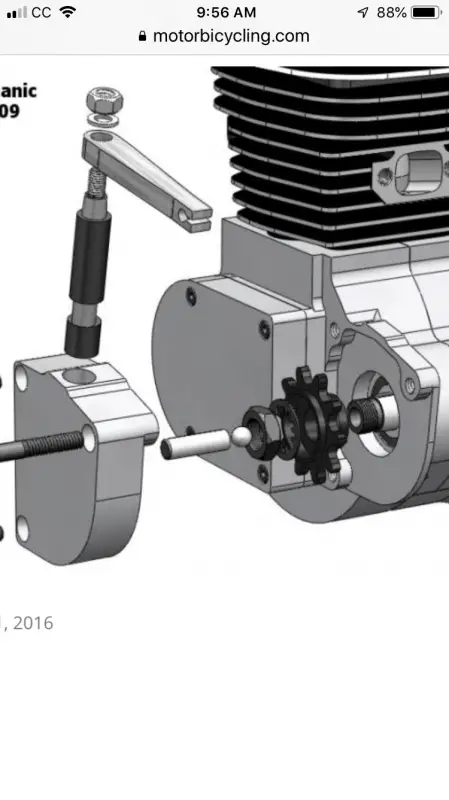

So I bought a spring loaded chain tensioner that mounts to the clutch case. When taking one of the bolts out, a nut dropped out and it was covered in oil. Where does this go?

It goes on the top rear bolt which is longer, that bolt goes through the case and the jam nut helps keep it from loosening. The nut will be on the outside of the case.
Hmmm. Still can't find where the nut goes. Would you happen to have a link to a diagram or video? Sorry. Im completely new to this and i cant find any comprehensive video on youtube.
