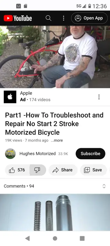

Watch some videos on YouTube Hughes has some good videos on this to get you going strong
