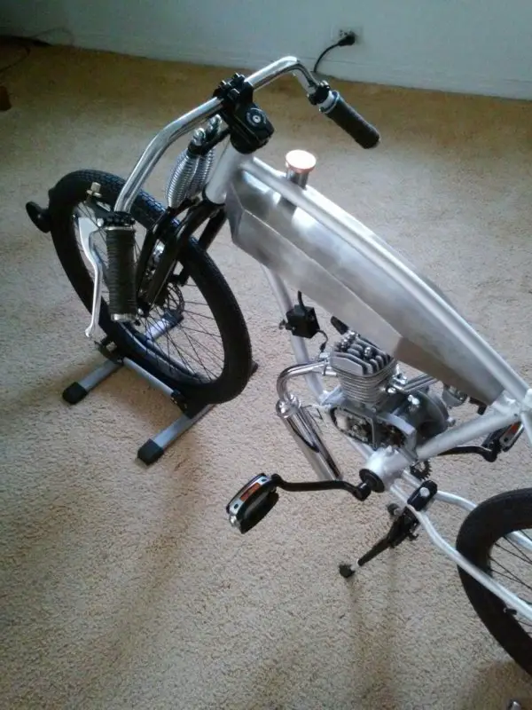

can you tell me if this engine is compatible w frame?

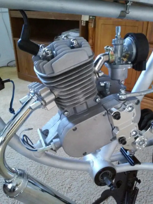

I built one of these frames out using 26" x 2.25" tires they don't rub but the 1.95" tires would be easier to deal with & a 66 cc that many refer to as an 80, I used the built in frame post but it wasn't well aligned & required some modification to make it work. If I had it to do over I'd have eliminated the post and mounted the motor using a frame clamp for the front motor mount. The tank leaked as well on a seam bend and That added about $50. to the price plus the work and time for the tank sealant...it's been a great little bike ever since though.
I used a dual spring fork which easily accepts 26" x 2.25" tires as well, but most any 100 mm wide fork made for 26" wheel & tire application will work as well.

Sunlite dual spring fork mounted using a mountain bike style ahead stem
Yes, wide cranks on standard bottom bracket set JAP taper shaft to clear.
Photos show early progress of the build using the components you asked about, the wheels shown are 24" but latter changed to 26" wheels & tires as stated in previous post...plenty of room on the fork it has the 26" length fork legs with disc brake caliper stand offs built in.. To run a disc on the front you need a front wheel that is also rotor ready.
I would call them and order a headset specific to the frame be shipped with the bike mine was a 1" but I've heard some are 1 1/8" as well as the correct bottom bracket set. The wide crank levers are usually square taper JAP and take a 1/2" pedal set, but I do have one that came in using a 9/16" pedal set.

did you not use the rubber mounts that the engine came with ? ive read biased opions on using the rubber mounts vs not
simply bcuz the engine should be as close to the frame as possible

I've made a lot of mistakes over ten years of building these things and & rubber mounts are not even close to a good idea on these China girl motors. Yes they vibrate & common sense says put rubber isolators on the mounts to counteract the vibrations, but while it may feel better at first the rubber gives and allows the motor to move even more and crack the frame. Aluminum is especially prone to cracking and is extremely difficult for the average guy to repair, but steel cracks too and if your fortunate you won't go to hospital for stupidity and broken bones. That's why Jimmy says it's bad stuff...what works on perfectly balanced motorcycle engines and cars doesn't on these little 2 strokes and though I've balanced a few of m engines I never use rubber for the reason just stated.

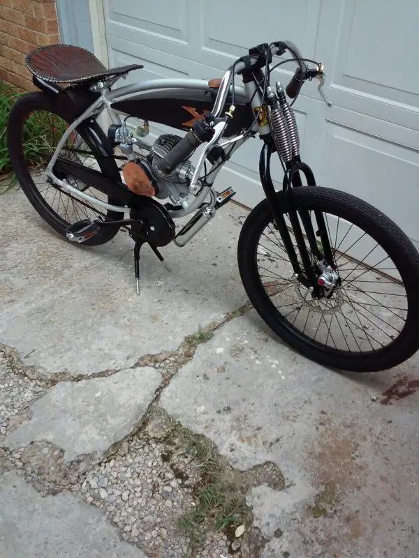

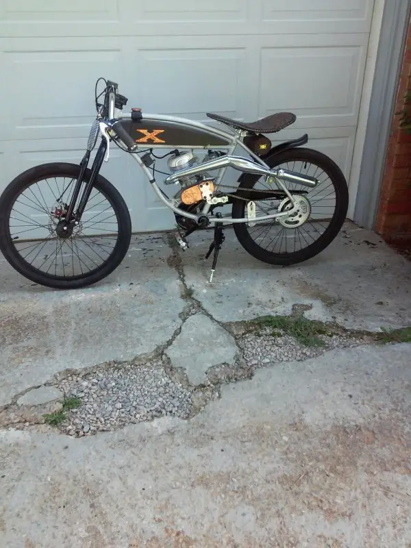

I just realized I never took photos of the completed bike with 26" tires on it, but here's a photo of the bike about 80% completed.
I'm pretty certain the engine began life as a ZEDA 66 cc, but only the bottom end of that engine remains.
