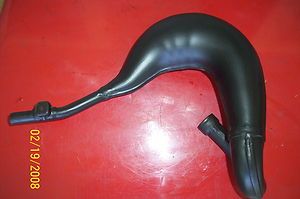

Can I use this pipe on my bike??
borntofli
Jul 27, 2012
306
16
tx
Its off of a yz80...
I have ht 66...
A little welding and a silencer and I think it should work well....

Yes you can. Be sure you support it somewhere besides just bolting it on the exhaust port.
You should pick up some power too.

I'll be watching for your results.... I was just given a pipe that resembles that.
The header on the pipe is quite a bit large for these chinagirls, probably because the dirtbike engines are ported very well in comparison... but you're in the ballpark. If bottom end gets lost somewhere, I'd start with grafting 20" of your stock header onto where the first cone begins.
and all thats just a wild guess ! get a second opinion! :)

hey there i am... the pipe lost a little on the low end over the pipe i had before that (homemade expansion) but it screams on the top now, though i feel like my engine doesnt rev up enough to really maximize the potential of the pipe.
i love the look, sound and performance of it though. it was a little hard mounting it to the flange on the head because the diameter is pretty big but with a grinder, a cheap HF 90 amp welder and a little patience it can be done.
