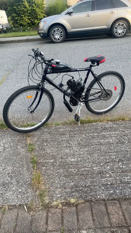

Built an absolute screamer
So I been building these motorized bikes for some time now and had this engine kit laying around in parts in my garage for months. Decided to go out and buy a cheap bicycle and throw it together took a couple hours. (First time I did this it took me nearly 1 week!)
Every one of these I’ve built with the standard 66cc china motor and NT carb + 26 inch wheels 44 T sprocket has done about 45km/h to 60km/h. I was expecting this one to do about 35/40km max as I didn’t really mod **** on it. But WOAH I was ripping down the street doing nearly 85km/h and I weigh 220lbs! I wasn’t even full throttle as well.
Is this a fluke engine or what cause man I didn’t expect that. One thing I did do was port the cylinder intake and exhaust it’s also a G4 open transfer cylinder. Gonna check the durations and see what kinda numbers I got running on this. Also I got the squish down to like .7mm which is important. Oh also I just remembered I either advanced or retarded the timing a little I can’t remember. I guess I did do some mods now that I realize it lol. I use 94 Octane ethanol free and 40:1 ratio

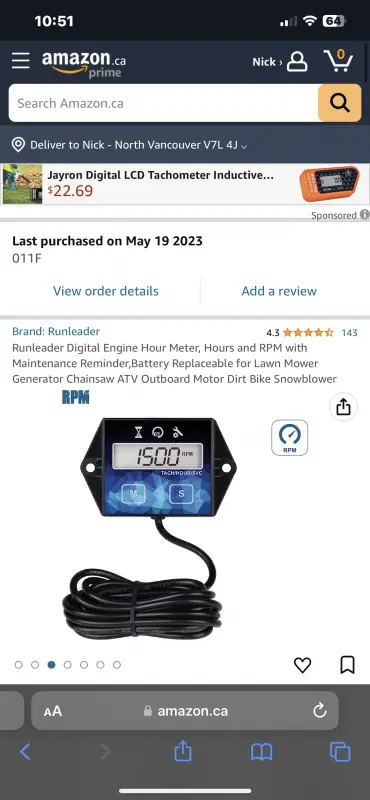

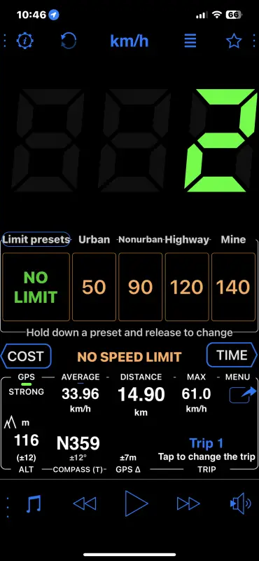

I use a Speedometer app on my iphone that has been extremely accurate in my endeavours. For some reason, that night I clocked nearly 85km must have been a glitch because I hooked up my amazon RPM tachometer and gave it my all just now and I clocked 61km, absolute max it would go and I tried to glance down at my tach and I saw roughly 7,500RPM. The max speed I was going tonight feels about what I was doing that other night so there’s no way I was going another 20+km. It definitely glitched.
61km is still really good in my opinion for 26” wheels 44t sprocket. Now i’m wondering, what speed I would hit if I went lower on the sprocket.. Going 60+km on a bicycle is kinda terrifying it feels like the engine is gonna explode lmao

Those GPS apps are notoriously inaccurate. At 7500 rpm using a 44t rear sprocket on 26" tires your speed would've been 51.7526887359 kph.
The 61 kph could've been a down hill reading. There comes a point when your engine is no longer contributing to a down hill speed and gravity has taken over. To do that speed with your setup on level ground would require your engine to do 8841 rpm. Get an actual speedometer.

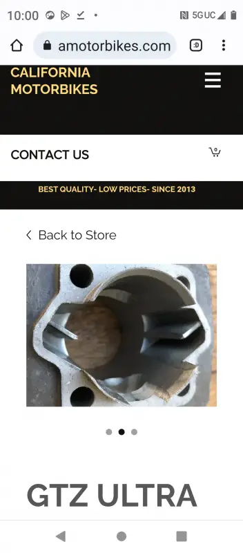

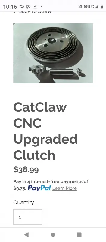

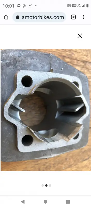

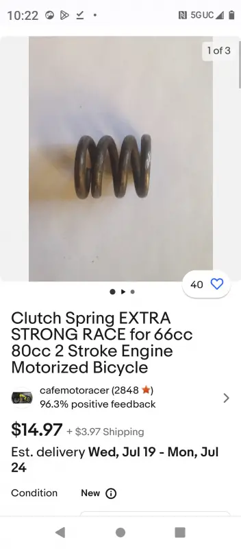

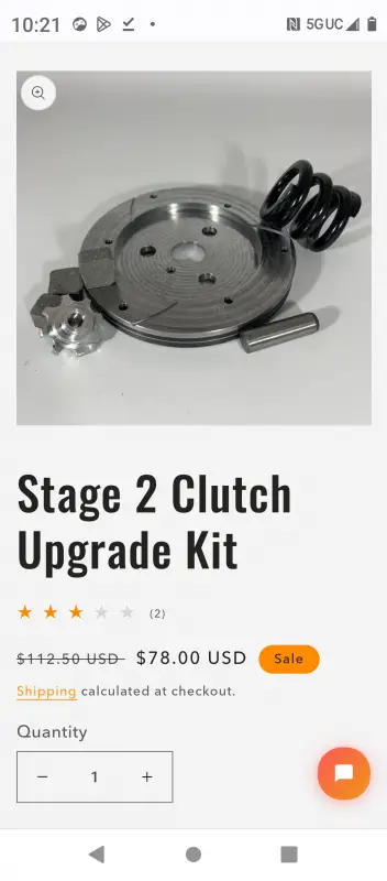

Something new... I shouldn't be posting this until I get a few to look at... But anyway California motorbike has a CNC clutch... Cafemotoracer has the spring... So you don't have to wait for years for RDM to complete a transaction... not having to deal with RDM is great...

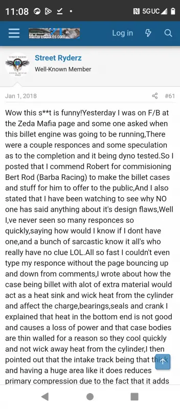

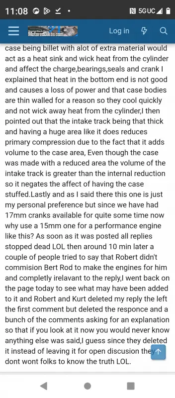

The other forum has black listed California motorbikes so they can promote bicycle engine.****... RDM did the bushing fix for the original phantom and there all linked with the Zedamafia crew who ripped off people for years... Anyone remember the pre pay program where you never got you mz65 in 2015? The original CNC engine cases were designed by Burt Rod...
I'm just glad there finally getting some competition... What's the point of something great if only a handful of people can get it... I know it's going off topic... But how many people have been around for decades to know how these companies and parts have evolved? Who's legit and who's just taking your money... Making claims that aren't realistic...
