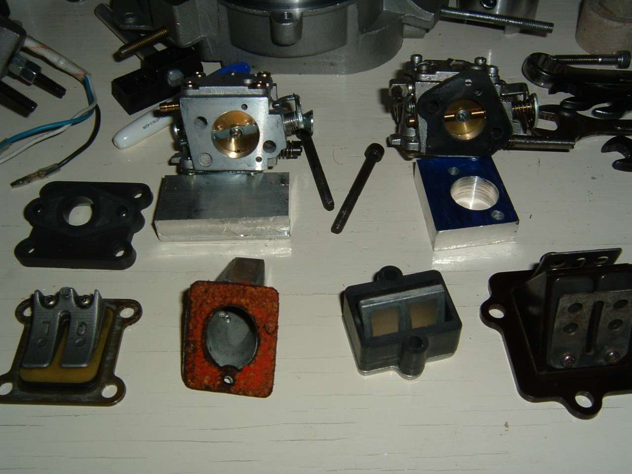

Here's my reed valve collection.. The carbs in the background are 20mm Tilly (18mm venturi) and the other one is a 13mm venturi Tilly...

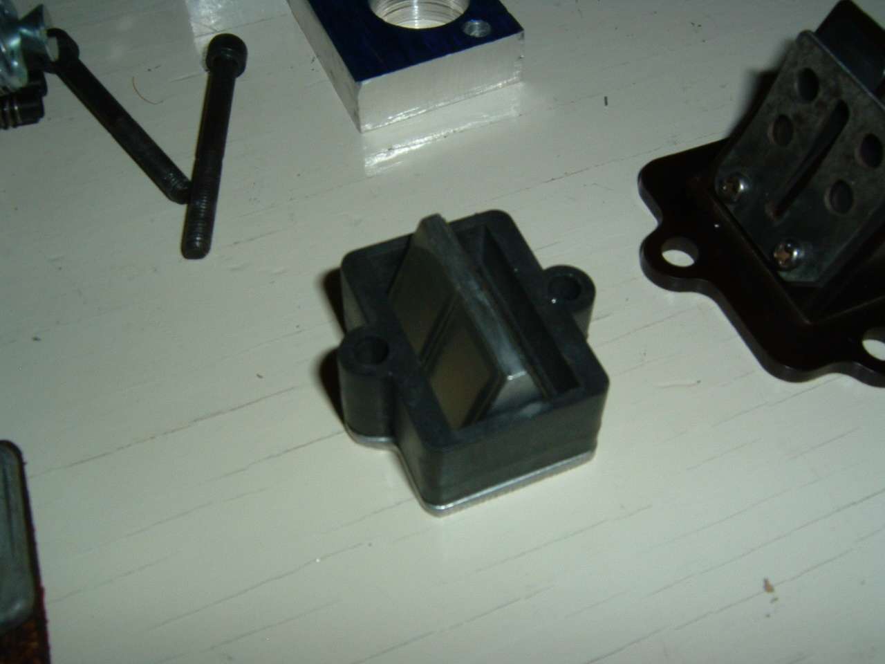

This is the reed for a 60cc RC model engine, it fits the 20mm Tilly with very minimal intake trimming, this one should flow enough to run the larger Tilly but it's very compact in size...
Saw the pic you posted in the other post and yeah, it's the same reed... I said it came from a DLE 60cc twin engine, but it's really from the OS GT60, I just looked back on ebay at my purchase history... It seems that I saw another pic of an RSE with the smaller reed in it, a black plastic valve with 2 large petals.. JN has it pictured this way, but I've seen them with both reed setups so one might be bigger? Looks like this one could handle about the same size carb but could be an older or a newer version? http://www.jnmotorsbikes.com/product_p/jnm1252.htm
I'm almost tempted to put one of these engines in a bicycle... 17.5HP @9k rpm and that's without expansion chambered exhaust... It could be run as single speed, but it would really be quick with a variator setup... http://www.dle-engines.com/dleg0170.html they also make a 4 cylinder version that makes about 22Hp @7500 but it may be too wide to be practical... The price for the 111cc twin (11hp) is comparable to a KTM clone and the 170cc price isn't that bad either.
Davezilla, the problem with these engines is they are designed to run at a constant high rpm for a prop. The few I have seen used on other than planes all were peaky and very temperamental. I saw a guy stuff the inline twin in a monster/staduim/basher rc truck and while it was super fast, it was a pig in normal use and basically a on/off switch type of motor.
Your variator idea sounds interesting though...might be a way to spread useable power by clutching it correctly.
But be aware, they will never run like a motorcycle engine.
