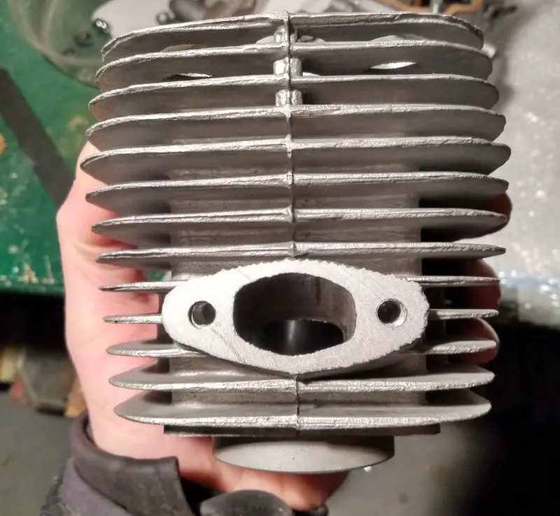

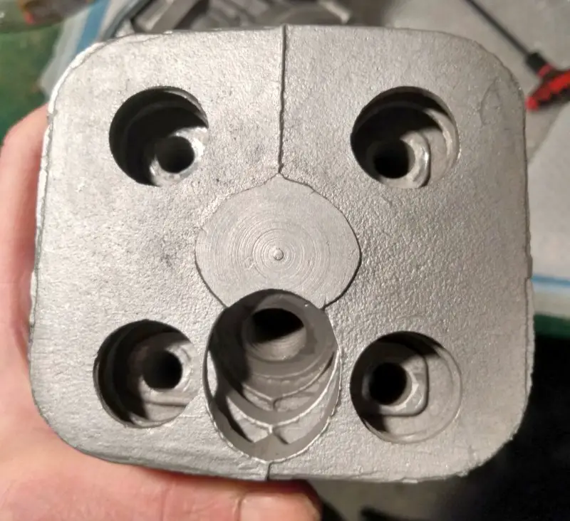

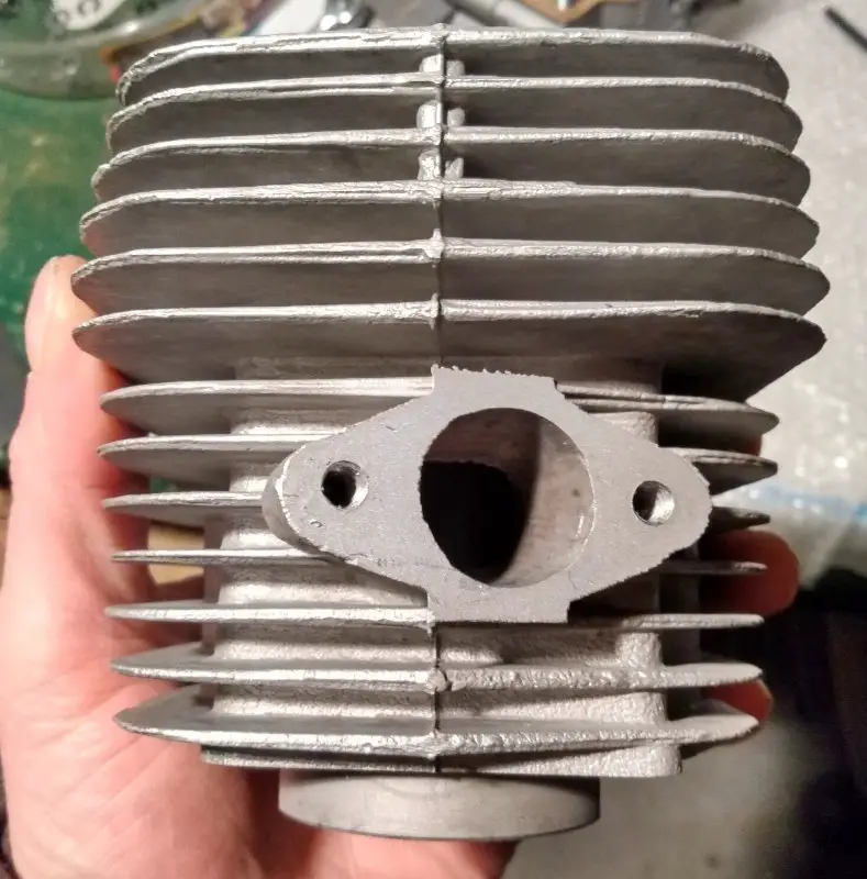

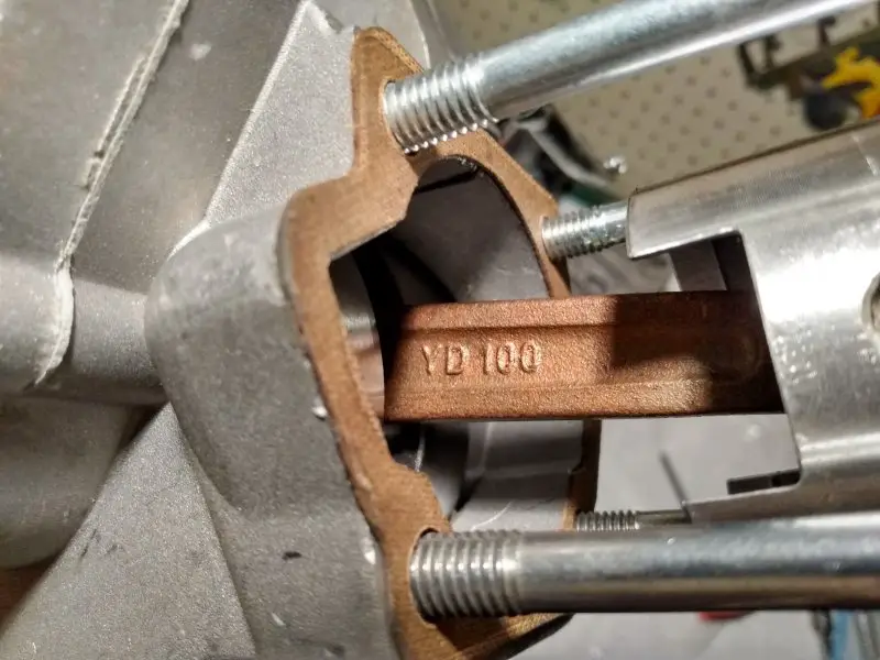

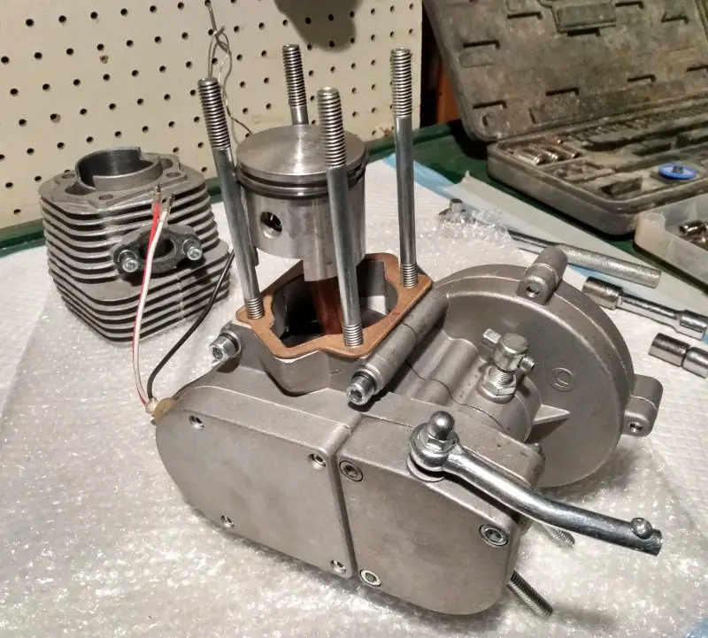

So the motor has arrived.
All lookin good out the gate.

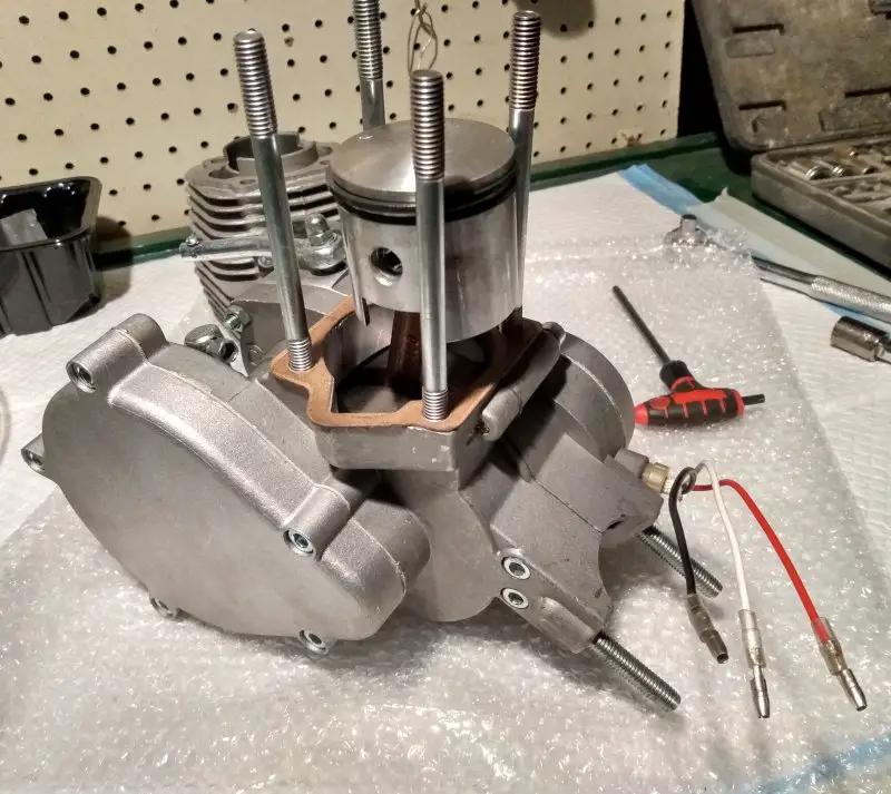

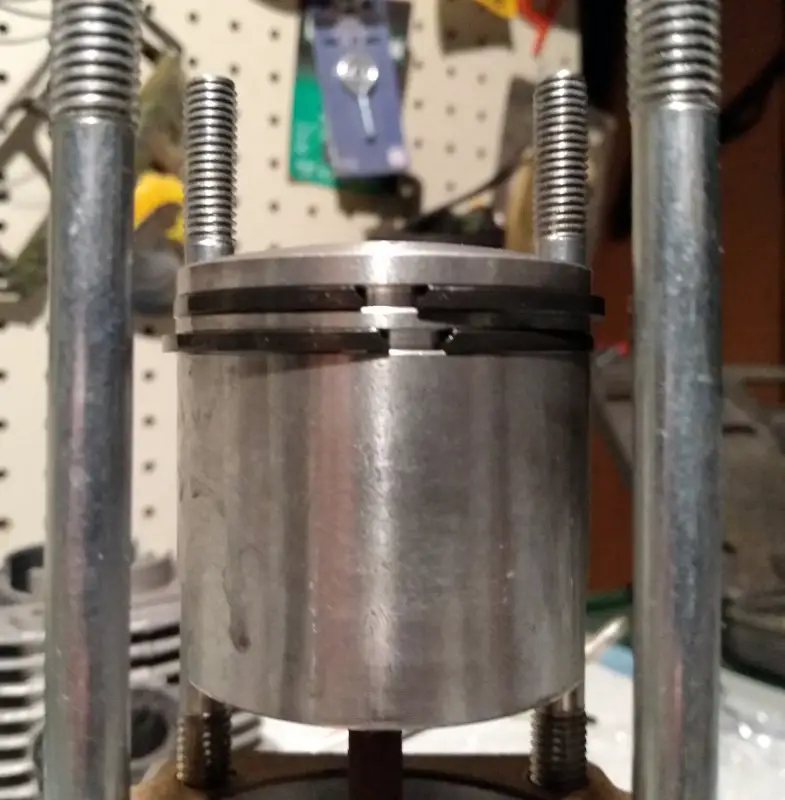

Was the piston installed correctly? With the larger bore I was wondering if the ring end might be outside of the ports if installed either way.
piston was installed correctly.
there is nothing to stop the rings from spinning in their slots.
is that normal?

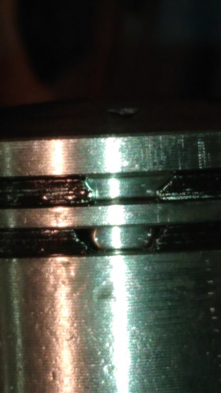

The 40mm ad 47mm pistons have pins in the ring grooves to keep the rings in place, the pins are located on each side of the intake port.
Look at the ends of each ring if they are designed for locator pins they will have a half Moon cut on the bottom half. If the ends are flat they aren't.
That's too scary too contemplate.
Years ago. Holed a piston in a Zundapp. Couldn't find no Zundapp piston but a Yamaha had the same dimensions. Except for the locating pins. It fired up for about half a second when a ring snagged a port and chunked the cylinder.
End of Zundapp.
End of Zundapp.
there are spossed to be pins in 2 stoke pistons, yes?
So what now?
new piston? modify this one?
Looks like the ring ends do have a taper so spin the rings all the way around and look for the pin. There’s no way for the engine to last if the ends are not stationary.
ok.
So I found the pins. small victory.
thanks for u guys or I'd be truely lost here. lol

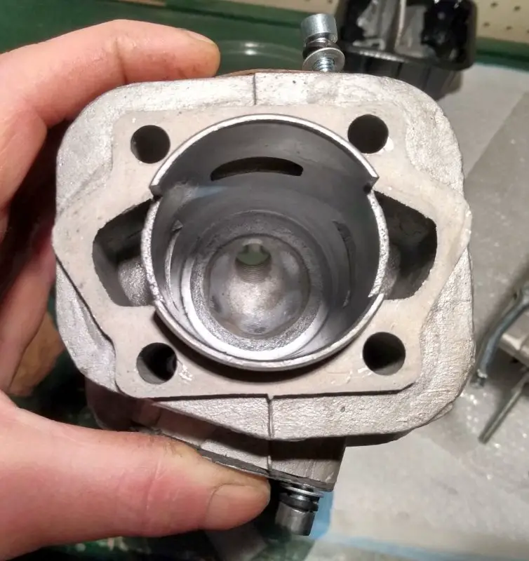

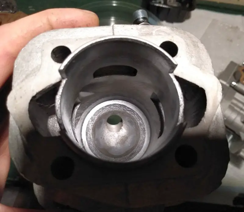

So, I got the flash cleaned up, transfers smoothed and matched a bit, matched up and textured the intake track/polished the exhaust port and got the gaskets trimmed up.
Gonna figger the mounts next.
once she's on the frame to my satisfaction, won't be long for first run.
