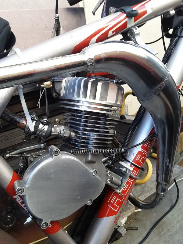

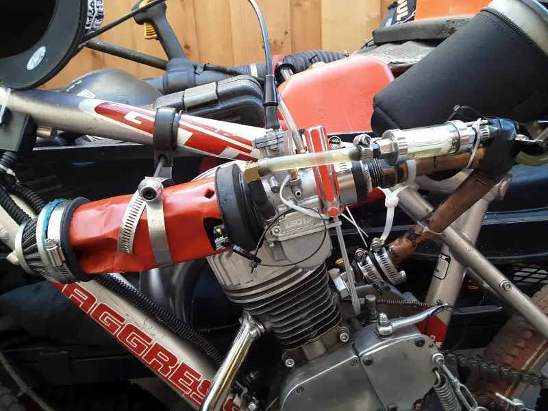

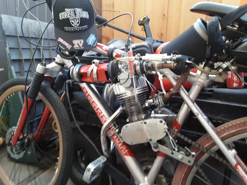

Now that red thing is my splash guard for the fuel that sprays out the front with the normal filter normally, it loads up with fuel and bogs soooooo the canister is a modified paint can from there the 21mm pwk ,long intake copper a buddy made that ,rubberhose and hoclamps,pretty intake with hole now plugged, the I believe a zeda 80 with a ported polished cyl and piston,44trear and dude it's almost like a dirt ike but one gear fat powerband winds up fast had it together for 5days now break in period for ever but this ant no hobby any more it a way of life for me now so I gotta have my whip rollin .........peace
Great looking bike, and yea the boost bottle should help stop that back surge alittle however you probably have some weird harmonics going on with your long intake runner 21mm is a really big carb, usually ive seen 18-19mm so all that extra fuel not going into the cylinder is being pushed into the bottle to flood the engine later
