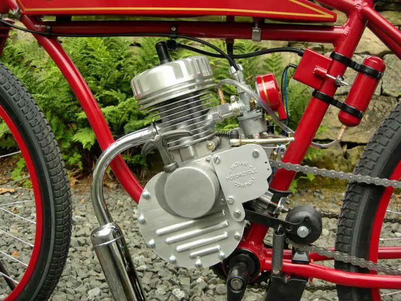

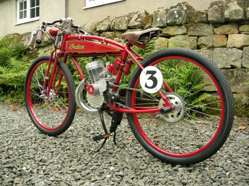

I fitted a boost bottle to my first CG build. Performance wise, my findings would appear to indicate it does little other than look interesting and fill the space between the seat tube and rear wheel nicely.
I've seen those 'turbo fan' deals advertised and, performance wise, my guess is they'll have about the same effect as putting a lolly (popsicle) stick in your spokes. Save your money.
