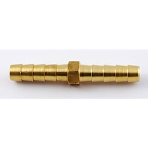

Buy this: http://ecx.images-amazon.com/images/I/31i42mEq9kL._SL500_AA300_.jpg
1/4 hose inside diameter double ended brass barb coupler. ($2 at Home Depot or Lowes)

Yank out the plastic tube under the spray button, and drill it through with a small bit, then a larger bit just slightly bigger than the barb. A rat tail file also works. Wash out the can and dry it in the oven to make sure its absolutely dry.
Put a cotton ball or paper inside the brass barb. Now epoxy the heck out of that thing, to glue it into the can. Try to get it straight as you can. With the barb plugged, you can hold the can upside down and press the barb in until it sets. (don't glue your finger!)
Remove the paper with a drill bit or coat hanger. If you have to, drill through, carefully. You can expand the hole slightly but don't over-do it or it will crumple and twist up on the running drill bit or the bit will seize.
