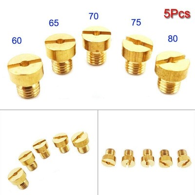

Very good. Thank you gentlemen. I noticed bikeberry sells a jet kit of 5 that go from 65 to 70 but they are out with no projected restock date. Do you know any place else that sells them in small increments from 65 66 67 68 69 70? I have been contemplating buying a drill bit set and doing my own but from what I hear it needs to be pretty precise.
Any thoughts?
Any thoughts?
Here are a few on ebay

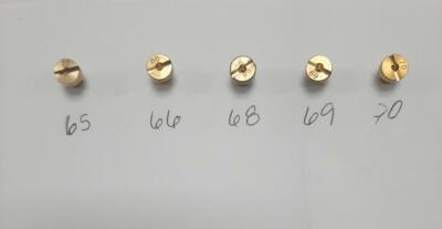

God I searched high and low for those. I love you guys!!!! WOOP WOOP!

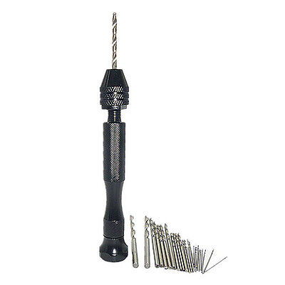

I'm not quite sure why they don't give you a #67, but, if you are really interested you can make your own. All you need is some solder and a micro drill set. Just put some solder over the jet hole and then drill it out to the size you want.

With these cheap 2-stroke carbs, I prefer to solder & drill my jets... With the big 4-stroke engines (& motorcycles), I bought a nice jet kit.
When you solder & drill... only use a tiny 'pin head' size bit of solder!!! It helps to keep the jets original shape & internal size & it's easier to drill.

Yes you are both correct and I considered doing that. I build bronze sculptures and am very steady handed and will more than likely go this direction if I need to.
