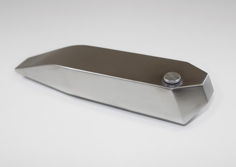

if you have enough mony you can buy one from sportsmanflyer, he produce 2 different tanks
?: SPORTSMAN FLYER MOTORBIKES :?
you can also look for some old fire extinguisher for a torpedo style tank!
i´m in the making of a tank out of cooper, you can solder them at home and need no special tools or knowleg!
sorry for my bad english
greetings from germany
The Sportsman Flyer tanks are very close to what you are looking for.
Sportscarpat's tanks are made for just two frames that I'm aware of. One is the old Schwinn straightbar frame (Panther, etc.) and the other is for the Worksman NewsBoy. You'd need one of those frames unless you were going to build a frame around the dimensions of the tank. I don't know of anyone selling cylindrical tanks. I don't see why you couldn't make it any shape you want out of fiberglass. For someone to do a one off tank for you would be expensive. A lot of work and time goes in to making a tank whether it is of steel or copper, brass, or fiberglass. Not that it isn't worth the effort. It is.

Hi Guys,
Thanks for the kind words on my tanks. The ordeal that Whitey and I went through was just the worst. We tried to keep shipping costs down so the motor was attached to the frame before shipping to Australia. Customs decided it was not a bicycle but a motorized vehicle, which is more difficult to get through customs. Lesson learned. There is no problem shipping bicycle parts, though, as I have done so since including even a frame. The motor bike related parts like gas tanks, etc. should be shipped separate. I feel for you guys down there as it just doesn't seem fair that shipping costs should be so high.
Pat
