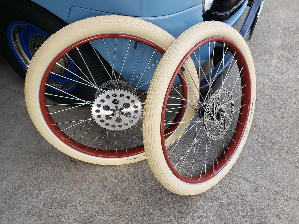

Great looking wheel set & I'm certain the completed bike will find a proud owner. I'm a fan of the Fat Frank's, they look wider mounted than they're marked size & they ride nice.
