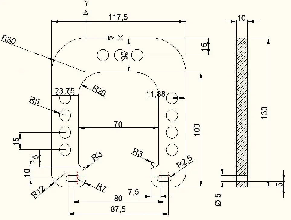

Just for anybody that is interested, I found a site where someone made their own v-brake booster which is similar to the old v-brake adapters. It was machined out of aluminum, but can be made out of steel. It is a full size drawing which you can print out and trace onto your metal, as a pattern. Extra holes were drilled in the legs to lighten, as well on the top, left and right of the center hole.
*You'll have to change your print settings to "Landscape Mode" and change all the margins to 0.25 to print out properly.*
http://motorbicycling.com/attachment.php?attachmentid=49348&stc=1&d=1340781884
