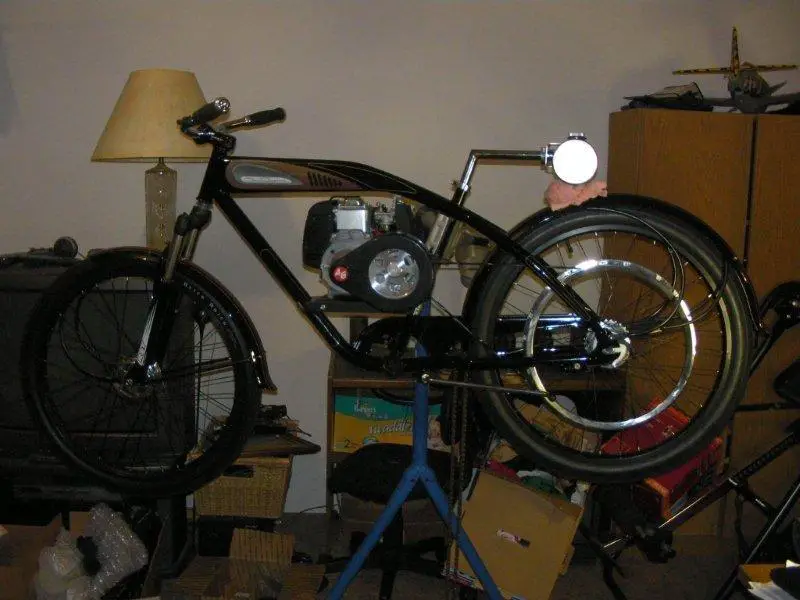

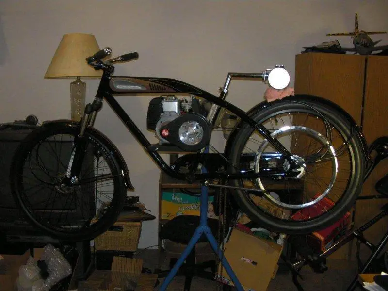

Hi All
Well Rare Bird is finally coming together should be done by the end of the week I hope.
I have a few pics to show BUT the back ground is cluttered and it takes away from the pictures. At this point it is not easy to take off and put back on the bike stand so you get what you get right now.
I will do better pics when it is all done.
Here is what is left to do, install the throttle, front fender, cut the rear fender for belt clearance, build the exhaust, mount the tank, find the right size of belt and install it.
I am think of changing the name slightly to Rare Black Bird as this is a very Black bike.
