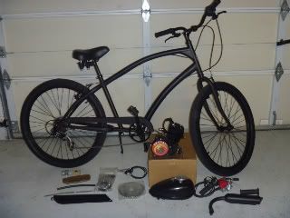

Before:

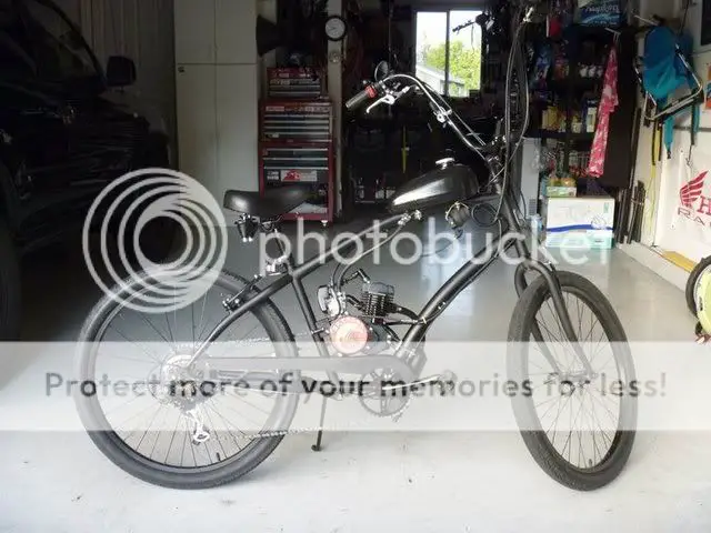

After:
The bike is up and running well. I have a few little things to take care of, but it's a real head-turner and conversation starter as I'm sure many of you already know from your own builds. The cool part is that I was originally worried about local law enforcement harassing me when I took a ride but my neighbor, a sheriff, basically said, "don't be an idiot and we won't bug you." He also said, "we have better things to do." He made it clear that if it was under 50cc's then they were not concerned. Sweet!

Before:
After:
