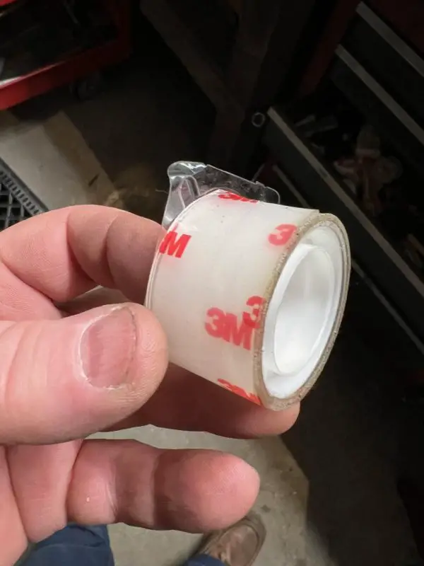

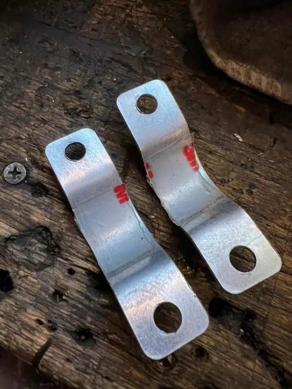

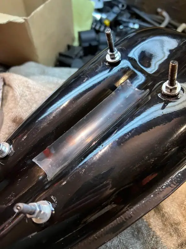

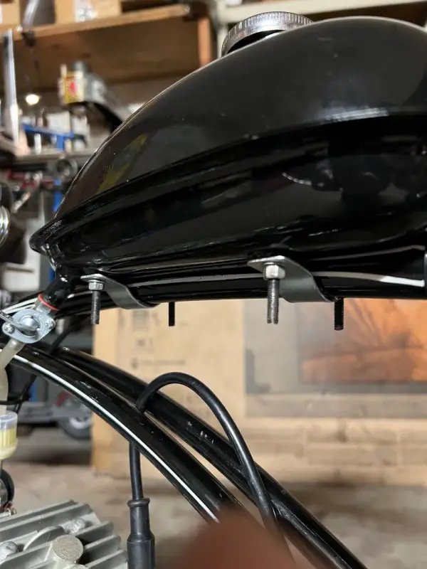

Here's the pics of how I use the two sided tape on the gas tanks...
I had to remove those nuts & washers you see on the tank before I installed it.
They were installed by the customer before he brought the bike to me to fix...
(he was probably watching the same bike berry video you were)!! laff
