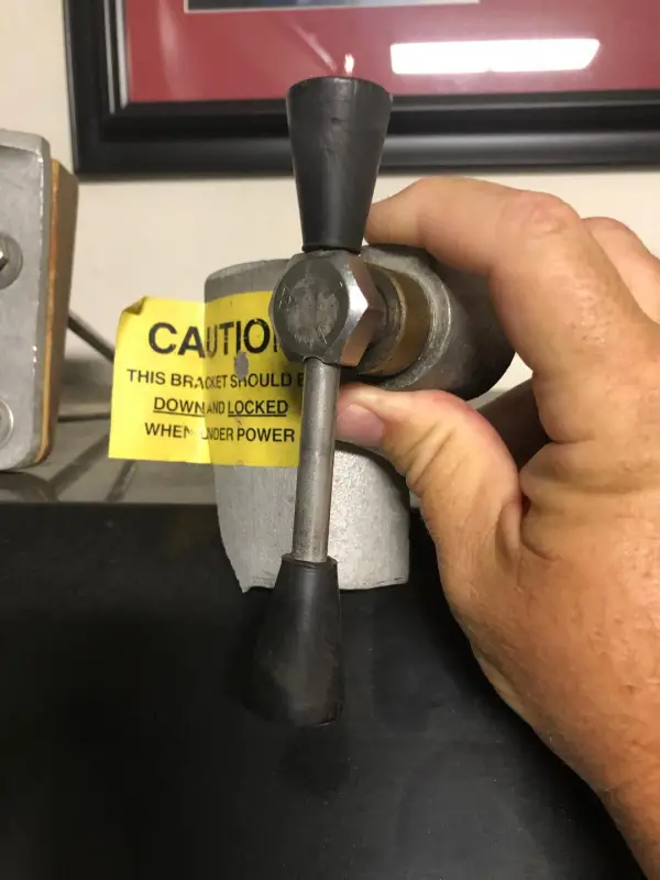

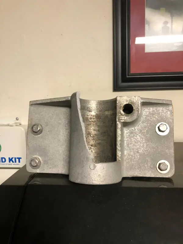

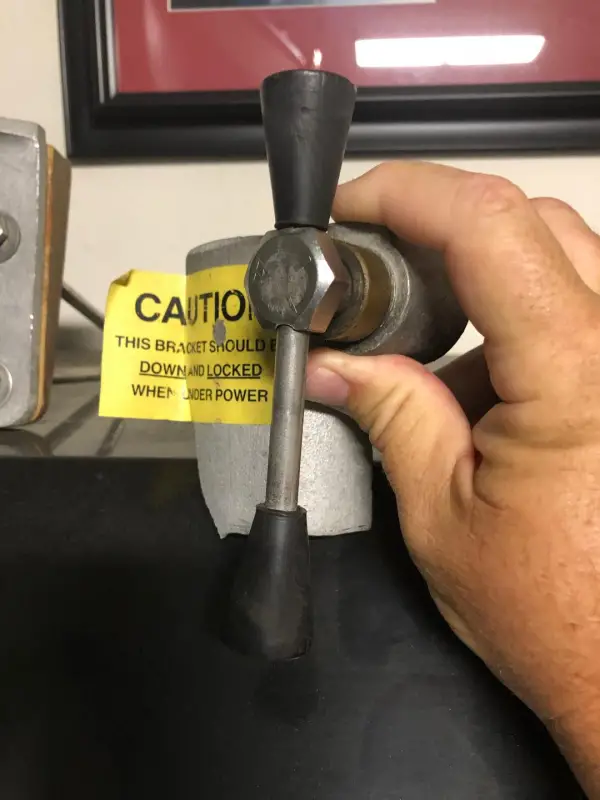

You there? The non client has a broken aluminum casting.

You are the Primo welder Rick, I think you can envision the original structure. Slotted on the right side centerline and radiating some inches lower to the corresponding centerline stop hole. Question is, Are the two pieces weldable?
TIG with a copper or brass internal block.
Tom TIG is the welding answer and with a copper backer to keep the bore relatively clean. The casting is really thin at the point of repair so minimal chamfer available, but the welder should use what's available to obtain more welding surface area. Great surface prep of course. Typically on cast oven heat just prior to welding, but aluminum starts to oxidize immediately after cleaning (bad) so I don't recommend pre- heat on aluminum, but warm parts weld much better than cold. Some weld contour, a bit outside of the weld area can lend some strength, not really mounded but a little higher than surface. No grinding after weld. The operator needs to be very conscious of excess heat spread or cracks on the edge of the weld will develop. The job is fairly labor intensive as small jobs often are yet much quicker than recasting or machining.

Pretty much what I expected of your recommendations. I will pass your words on to this 1987 Boston Whaler Montauk owner Eric Johnson, who will appreciate the extra expert welder insight to let him make a educated selection of someone to do the repair.

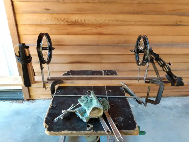

I ordered some Nichrome 80 wire sample kit. It contains a variety of 8 spools of different gauge wire each 25 feet long. Online I saw use of special electric knife to cut seat foam. An electric kitchen knife was also shown making it not quite as versatile but worked. Hot wire cutters were for cheap to way expensive. The cheap ones just did not have a 2 foot span to cut. Heck I'll have 200 feet and which diameter to choose probably in the middle at 26 gauge. The transformer I have can do 15 amps at 16 volts AC. No need for that much as a chart has a guide on how to get 600 degrees on the wire with other parameters entered. I would be using less than 5 amps and maybe like 3 amps. I can ramp up and use a thermo couple or infrared thermometer and see what I have at each setting. Making a concave radius curve cut maybe not necessary as I have seen where notch cuts allows bending medium density foam. They showed the notch cuts and then using a spray on glue and a result of a nice 90 degree corner bend was achieved. The feel of the foam though would not be consistant though out the foam, so for this large radius cut I would want to have the ability to do both concave and convex cuts. I have an idea to use some rims with the axles to connect to a platform. The platform holds the foam firmly and rotates it a specified distance from the axle to get the right radius curve cut as it passes through the hot wire.

Hot wire foam cutter apparatus being constructed. I plan on using Nichrome wire that I have an assortment of gauges. 25 Gauge 2ft I will have heated with train transformer to adjust around 600 F for the wire to cut seat cushion foam. Half the Diameter of my 15-inch Diameter Inflatable Boat Pontoon is 7.5 inch radius.

To make a precise cut concave shape that matches the radius of my boats pontoons I have a jig I am making.
The 12-inch kiddie wheels are a 6-inch radius from axle. I have the threaded rod to adjust outward to 7.5-inch radius for the curve arc I want to cut accurately. A concave cut on the seat cushion foam is to be made. The foam material is to be placed in position and not move while under the heated Nichrome wire from above.
I am to use the cut concave shape of the foam to have the foam seat mounted on the boat pontoons near the transom. A few straps and D-ring glued on the pontoons and maybe Velcro will attach the high denure fabric zippered case I will sew for the cushion.
Not done yet. 180 degree the other side of the hot wire to be connected to the threads you see mounted nifty in the valve hole on the rims, will be one of the pieces of wood dowel or flat wood long enough to gang the two rims to move together. The cutting wire on the opposite side slices through the foam. Thinking of a way to make a constant pressure and speed to make a nice cut. First I will try on small pieces of foam, don't want to waste any, but I have twice as much as I need anyway.
An extra table and shims for a flat surface to meld the work bench together so I manage the large foam section I purcased will be the way to go. Hey my handle Measure Twice is synonymous with cut once! But additionally keep the largest remaining piece after cutting is wise as well. More foam available for another project if less small pieces not good for much are ended up with.
