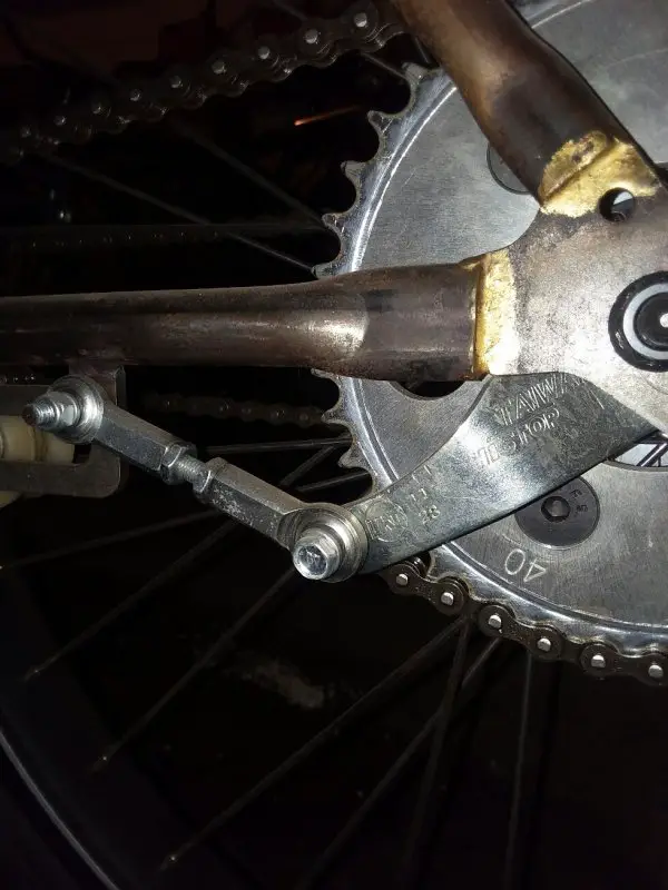

When I installed the catch can I didn't take note of how I went about it and the tool box top mount was fighting me today and I had already tightened the pair of seat tube clamps. Classic do it twice to do it right once but this being as I have not been chasing a completion date with due diligence I reap what I sow.
Also because I saw a chain line misalignment of the Shimano sprocket and the pedal sprocket which appeared to need a little more inward movement. Today the pedal sprocket got counter sunk mounting holes to accept ¼ 28 Torx flat head screws, replacing the hex head ¼-28 bolts.
I have been going nuts with Torx flat head screws but they are superior fasteners.
Started to re-hang the rear wheel but the primary bolt to mount the coaster brake arm is too long, as.I was spinning the rear wheel and getting a dragging sound, it was that bolt. The primary bolt as I call it ties the brake arm strap to the brake arm.
Pat warned me of the brake arm mounting strap not keeping the brake arm stabile and after the strap and brake arm both were distorted in a heavy braking event The cause was I am sure mine, but that is what I have changed. The primary still keeps the brake arm stationary but a secondary clamp 3x.5mm bolt will be used to draw the brake arm mounting strap fast to the chain stay.
Friday is my last official vacation day and the Missus expects a well mowed lawn.
I want to get all three chains hung. I am expecting lash in some of the chain.
Old photos show bikes with a half inch of sag static and my drive side chains have been ran so we will see upon the morrow.

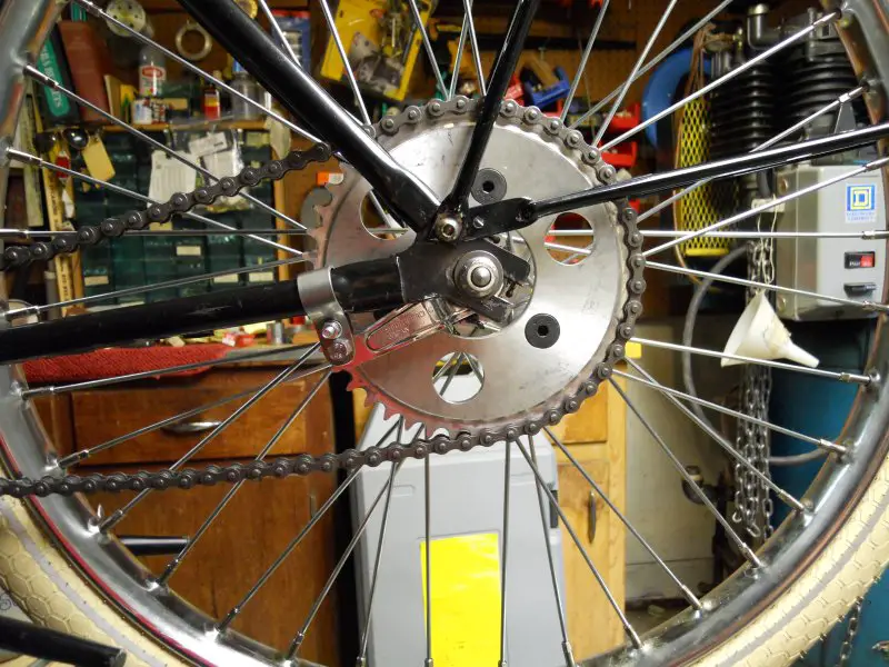

Check out my solution to coaster lever bands on a Sportsman frame. Works great.
Chain sag and whip I can't tolerate and with as many as three chains to deal with on some builds I use multiple tension/idler setups and spring loaded most of the time on both motor and pedal side. Some must like constant chain adjustment, but I don't and won't...now that I don't have to. I ride year round on several bikes & can't justify time wasted on problems that have a simple fix & that actually improves ones riding experience.

Well today I will find out if plan B is in order. The coaster brake arm has a 75 degree offset to clear the drive sprocket which is as close to the seat stay, as per Pat to get a straight chain line to the reduction drive sprocket.
The drive sprocket may not need to be that close to the stay as I made a 13T drive sprocket that is offset .220" toward the bottom bracket and still have .030" chain clearance at the bottom bracket.
But if needs be I can machine up a custom brake arm hanger.

Last year, I had the coaster brake arm come detached and it happened when I was coming to a stop at a intersection on
a country road. Luckily it turn around and lodged on a bolt that holds the rack mount. Since I have switched back to the
41 chain I haven't had any chain stretch even with the 212. I don't know if I can raise the motor enough this winter to
put a pedal sprocket on the bike not much room and to pedal that much weight would be a chore. Getting the pedal
sprocket/chain aligned along with the drive/sprocket chain is a pain. I have used two chain tensioners on the 49cc
which worked fairly good.

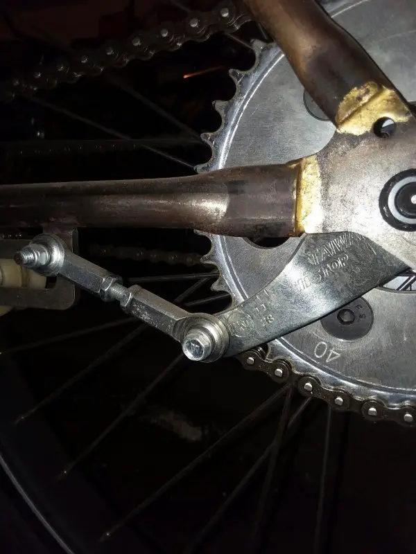

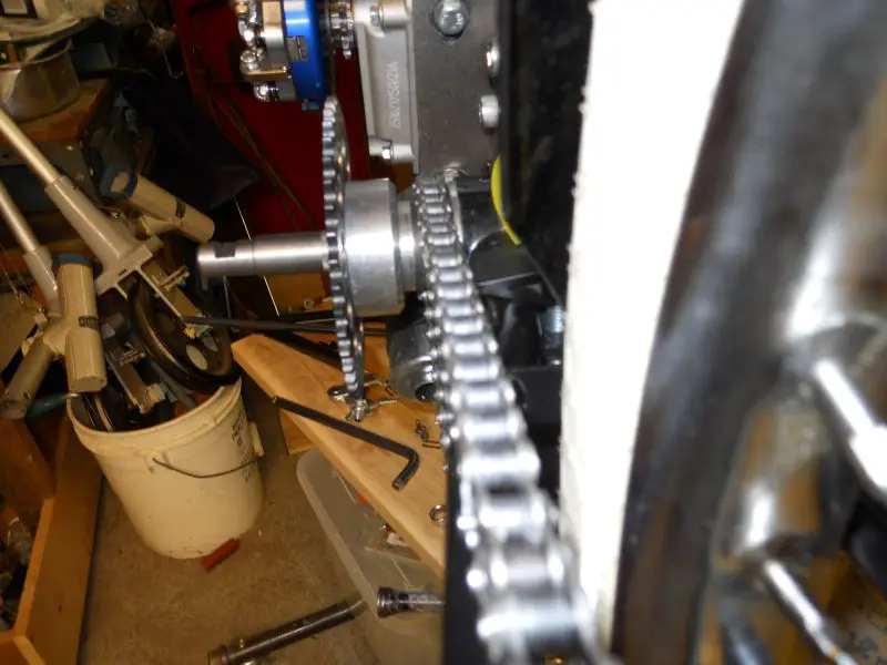

First thing was to rediscover what a handy tool a 6” needle nose Vise Grip is. Drew up the strap and arm with the vise grip and kept the holes aligned with a taper align pin. Bolt slid right in, took a measurement of the gathered assembly .300” and the ESNA nut .200”, the depth measurement from the outside surface of the assembly to the near face of the 42T sprocket .780”. So giving myself a healthy fudge factor cut the 5mm bolt .625” or 15.8mm, filed clean and chamfered with the same. I could have dressed the bolt face with my Kalamazoo 1x42 belt sander but I never took a step. Did the clean up and chamfer with a mill file to keep my hand skills tuned.
5mm back in and drew semi tight. Loaded the 41 chain and pinned it together. I added a ½ link to the chain as with a full link alone it was too tight and there is all sorts of room in the drop out slots to add more links. Axel bolts are not drawn up fully but plenty of clearance of the seat stay. I haven’t done a final check of chain line with my Lufkin 24” blade but my test is if the chain feeds freely both forwards and backwards and it does very freely.
Dennis’s comment that #41 does not stretch even when applied to a 212cc drive train is comforting as my 79cc in its present state of tune couldn’t possibly require any adjustment outside what the drop outs have.
