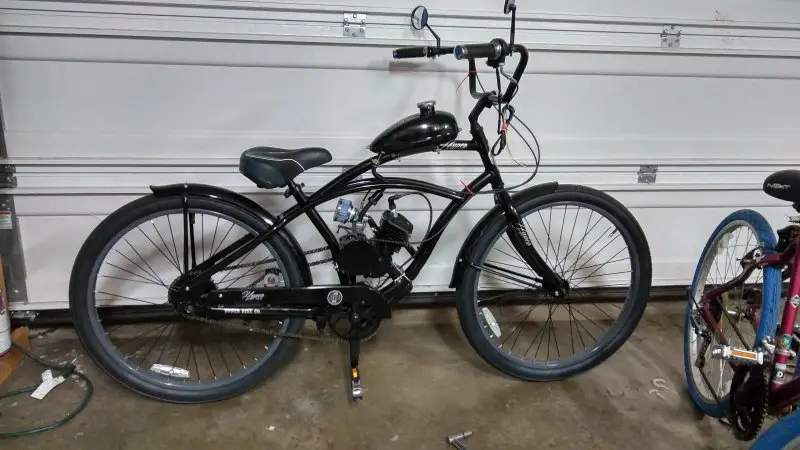

HYPER BEACH CRUISER $99at Walmart.
PROS: Good price, not a very common bike (you have to order it). Love the looks of the bike. Engine was an easy fit. Stock tension wheel works perfectly because of the oval cross-section of the frame where the tension bracket bolts up. Seat post is angled back. Not bad for $99.
CONS: Biggest con is the skinny spokes- they definitely are questionable with the rag joint. Fenders could use beefier brackets. (Surprise Surprise.)
All in all, I'm happy I chose this as my first build. This picture shows it with the Cranbrook rims on it and a Gel-Seat. (The original was really nice, too... but I used it on my son's bike. View attachment 95418
