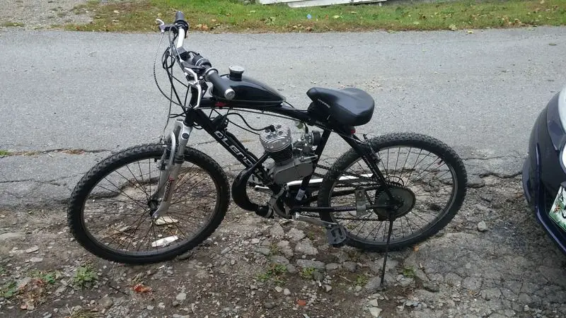

    Having a fat tire bike will give you better traction in corners and a smoother ride but in turn will be slower and cost more to fix flats and busted rims, I find myself breaking rims every 1-2k miles just from ridding but I'm pretty ruff on my bikes.
    For a fat tire bike I would reccomend getting the Mongoose Terrex. Keep in mind most fat-bikes even with a shift kit will need mods because the shift kit might rub the rear tire.
    http://www.walmart.com/ip/27.5-Mongoose-Terrex-Men-s-Bike/45146057
    I just used a Kent Glendale and put better breaks on it, off road Kevlar tires so I dont get flats every trip like I was. People talk a lot of smack about using walmart bikes but its not that bad if you replace the crap parts like breaks rims and tires etc other then that they provide some nice frames. I normally only replace the rear rim when I get their bikes.
    Heres a pic of mine;
    [​IMG]
    Keep in mind a fat tire bike will be very slow. Even putting a solid tube in my 26x1.95 rear wheel slowed my bike down to the point where I went out and spent the extra 50 dollars per tire on high quality tires.
    The engine is very small and weight impacts them a lot, personally I would stick with a generic steel frame mountain bike with front suspension, if you really want a dirt bike buy one, but these will never be like dirt bikes. The lack of rear suspension really makes bikes with fat or regular tires a really rough ride when you add a motor to the equation, but still fun. You might be able to find a TTR 125 for 500 dollars if you look around enough.

    That bike stock that I showed in the pic was $89 and I got the motor for $109 on eBay to just to get running before getting tires, which you could get that for free of a old bike. Your looking at $198 bucks and it held up great to some abuse and we mostly trail ride and travel on fields.
    Also to be honest all the hp parts I out on mine didn't do much...i didn't gain much acceleration but top end went up 7-8 mph. Stock the bike goes about 32 which is plenty fast I've noticed with mine high speeds feel scarry... My bike starts to feel unstable at 35-38 but it can cruise at that. I've hit 41 on a slight down hill road and the motor doesn't sound very good like it's over revving, makes a hollow sound like it's hit a limit and pushing more i think would blow it. I only keep my bike pinned about 10-20 seconds at a time when it's going that fast. I tested this here in Maine when it was 32f outside but when it's warm it looses power.
