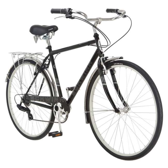

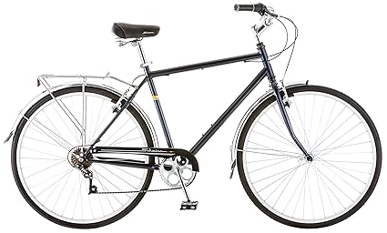

I work at a community bike shop and we just assembled and tuned a new Schwinn Wayfarer 700c bike..
18bebbecfddc43529260ae7c1a490392
I was pretty impressed with it's quality and how it rode. the brakes were great.
It's a pretty nice bike for about $200 dollars and it's got two V-brakes, upright handlebars, and a 7 speed Shimano rear deraillleur with twist shifter. Also comes with fenders and a rear rack, and the frame is the much required "v" fame in steel that CG bike engines mount very securely on..
I wouldn't suggest anything less for anyone considering setting up and riding a motorized bike.

What part of putting together a first time motorized bike with a single, unreliable and weak rear brake, on a bike that's notorious for cheap and unreliable, to ride in a hilly neighborhood did I not convey the danger of?
Motorized bikes are dangerous enough. Stacking the odds in your favor in Murphy's court is always a good investment.
Plus, setting up a dual brake lever is no more challenging than tackling installing a bike engine kit, and you move the twist shifter up the bar a couple inches, the room is there. It's real easy stuff, and you keep the shifters and brakes. If the owner decides he's made a mistake with motorizing this bike, you still have a decent 'round neighborhood cruiser.

The fact remains that better brakes are mandatory for motorized bikes and motorizing a notoriously cheap, dangerous coasterbrake only cruiser is a false economy. Especially with their weak wheels and the lack of two wheels braking. I'm sure someone could find a half decent 7 speed cruiser through Amazon for under $150.
This Schwinn stood out as having decent equipment and I've been a professional bicycle mechanic for 25 years, and I've seen a slew of cheap bikes from WallyWorld.
