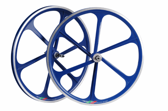

Hahaha, thanks guys, i'll be sure to tell her sup lol. Very true about collecting the tools. I'v got a pretty good colection of tools just had never needed a spoke wrench and spent my last spare change on it lol. Back to the main topic, does anybody know much about those plastic looking rims?
...ladies
Jan 27, 2009
130
Ohio
Ya i was talking about rims like these...
I'v seen a bike or two on here with them. Pro's and Con's of these? I love the look. Can't seem to find a price though.
