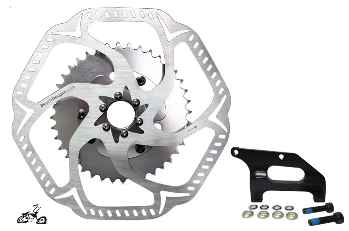

Ratt-Bones' rotor brings up a question. Has anyone every experimented with making a rotor from a circular saw blade? 203mm seems to be the biggest bicycle rotor available and as Ratt says, the bigger the rotor diameter the more stopping power it can provide.
I realize you'd need to relocate the caliper brackets to allow for the larger diameter and that the saw blade might be a hair thicker than a standard rotor but you could compensate for that in pad adjustment. I've made my own caliper brackets on two bikes and welded them to the forks. Moving them would be no big thing.
Actually if I try this I'd install it on the rear wheel on the sprocket side and the increased diameter would allow the caliper to mount outside of the sprocket/chain and not interfere with them as a 203 rotor does on a 40T or larger sprocket.
I'd probably leave the teeth on the blade too, just cause it would look so cool.
Comments?

That's big, almost 11". The price is a little steep but, hey, it's only money, right?
Thanks for the link, Gary. That would be the answer, if, you have a disc brake hub.
No problem, I found this while looking for alternative ways to run my sprocket, and run a disc brake. Easter bikes also used to make a hub that had a right side disc mount with the pedal chain on the same side. I ran it for a while when I rode for them.
