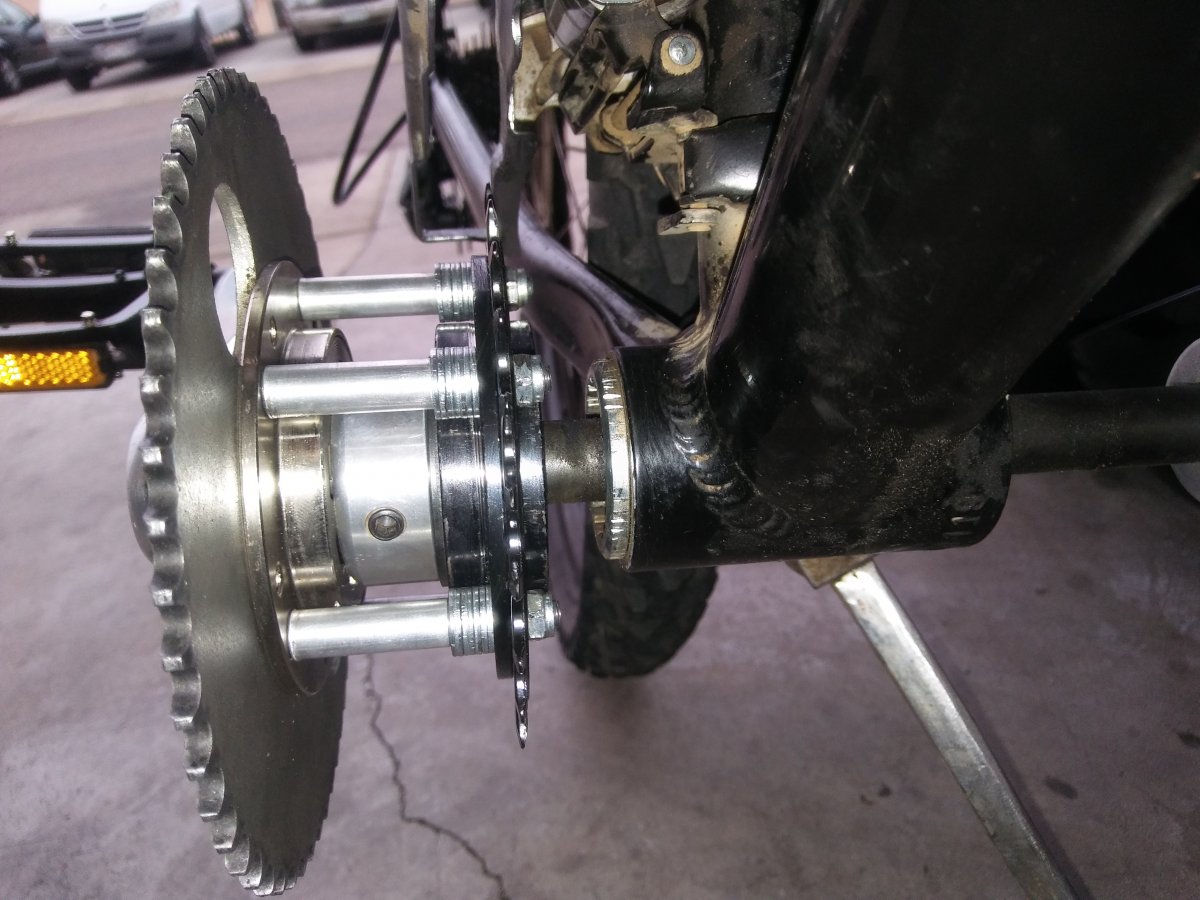

I also decided after the 1st sprocket ate it to run double freewheels. My sbp freewheel adaptor is stripped! boo! Oh well it was reinstalled with a shmear of loc-tite red and its really just a carrier bearing any way. It would be nice to make a properly spaced carrier spider but this works for now.
What's a carrier spider?
Can you post pictures of the shift kit on your bike, including freewheels, sprockets and freewheel adaptor?
In my present shift kit, the 24t chainring sprocket is connected to the 72t via five M5 bolts about 25mm (1") long. It works very well; the bolts have never shown any signs of twisting or damage. However, in your case as well as my project's shift kit, the distance between my 72t and the 24t chainring might cause twisting for 50mm long bolts.
Why take that chance?
Is that why you're using two freewheels? I'm thinking about doing that too, because of the distance between the sprockets. Seventy-five mm (3") is just too long. The freewheels I bought from SBP have two sets of five-bolt holes w/same diameter. That way, it'll be set up like two-section driveshafts, ala 1958-up Chevy.
I won't be using any set screws or locktite on the inside freewheel carrier. The carrier HAS to spin freely and independent of the bottom bracket shaft. I might even sandpaper the carrier's inside diameter, for less friction on the BB shaft. The carrier's new purpose is simply to provide mid-stream support.

This was before cleaning and changing around spacers, sprockets and freewheels
full

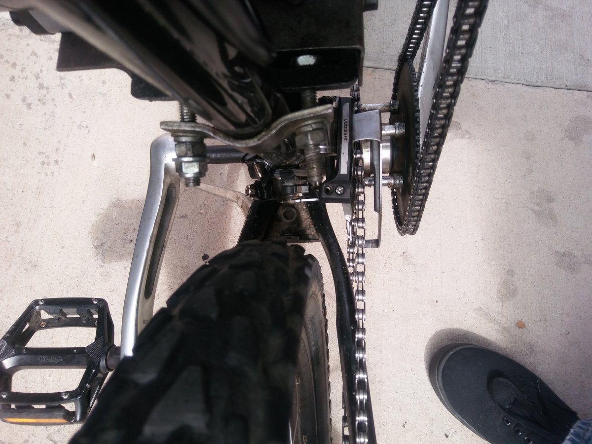

full
After moving things around cleaning an replacing a bent and broken sprocket

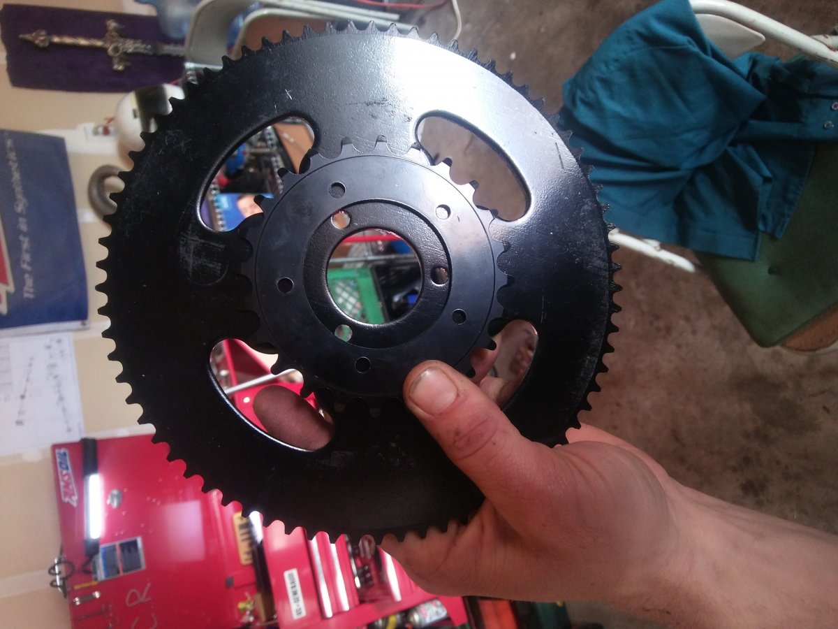

This is the 74t that needs matched to this pattern

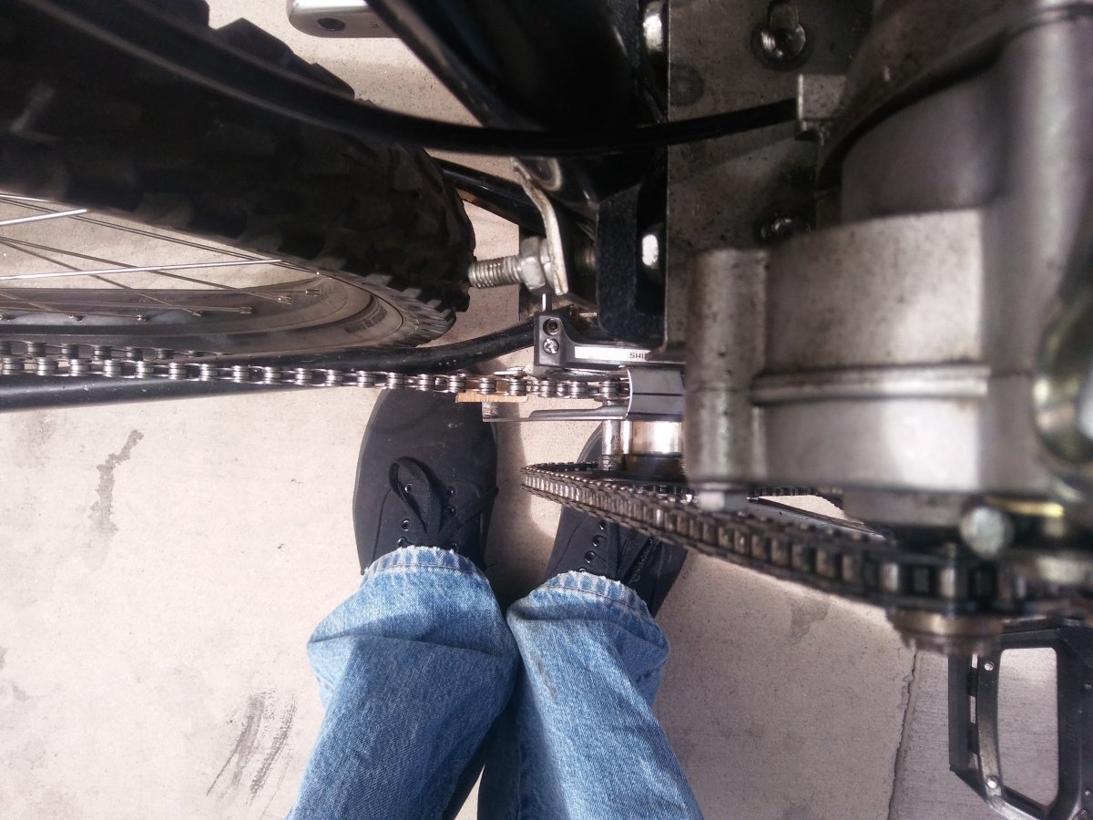

full
And this is the left side view.
Hey man tell it to me straight did I do good winging it?

A carrier spider if one existed would just be a carrier bearing inside of the 5 hole spider adaptor sbp sells. So I could get support for my long spacers without the extra freewheel I currently have. Yes the 2nd freewheel is because it twisted the bolts and spacers bad! The 1st 24t has 5 kinks in it to prove it. I would like proper steel spacers for either setup but
1 " aluminum was what was available along with washers to take up the slack.
Lol, you did good winging it.dance1
http://sickbikeparts.com/chainring-adapter/
This is the "carrier bushing" you might need.
I might need two (My bottom bracket is 2" longer than yours).The adaptors are cheaper than a moderately-priced freewheel. They also don't need to be maintained, lubed or replaced.
I might sandpaper the adaptors' ID's for less friction. No set screws or woodruff keys needed. They'll be "floating" on the shaft.
Well hello!... I just found this 72t #35 sprocket on Staton inc.
72t 5 hole sprocket for #35 chain

Your 74t T8F sprocket is 7.48" diameter; the 72t #35 sprocket is 8.75"OD.
