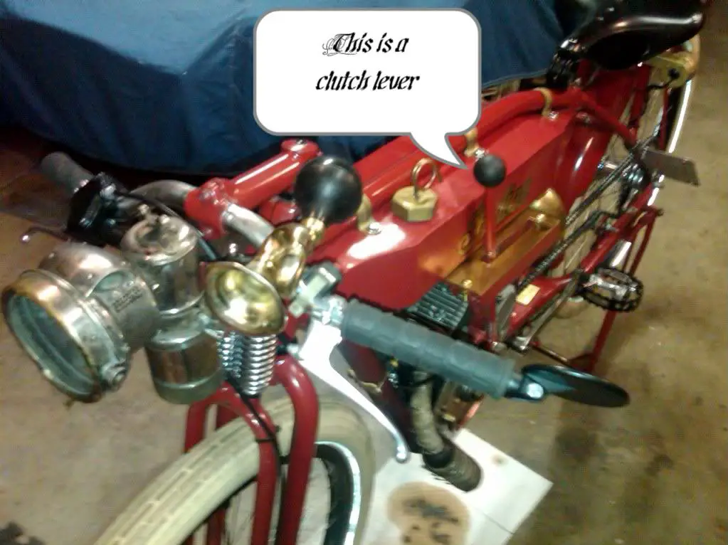

My homemade bike used to have a hand clutch but took too many hands to engage it, work the choke lever, twist the throttle and the compression release. So I changed to an autoclutch but will use the shift/clutch tank lever to engage a generator for lights in the future. The tank shifters really look cool.

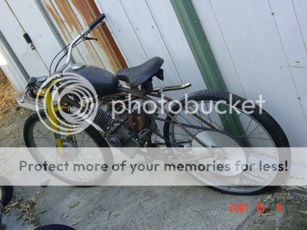

What really caught my eye wasn't the lever,(though that's cool too) it's the rear chain drive...PLEASE PLEASE...tell me more.

I trimmed the inner pulley rim down and welded a sprocket on so I could have a chain final drive. The centrifugal clutch is a product made by 3rd Millineum Energy for late model Whizzers (1999 and later). They ran out of parts and no longer offer them. I modified it because I suspected the rear belt was slipping because of the 8hp Briggs motor has so much torque.

I assume you are talking about that long handle lever that is so cool on one or the other side of the tanks. Although it is a cool addition (I intend to put a non-functional clutch lever on the 9hp Harleyish that is in the planning stages), because it is not functional, I think many of us are more concerned with the basics. I woudl like to add one to my 66cc stretched indian style bike.
What is interesting is that our 1918 indian (real deal) has one and the need for that clutch lever becomes readily apparently when you have to stop. You have the brake on the right, the clutch pedal on the left and guess what happens when you want to stop...you run out of feet real quick. It's not essentional with the sidecar (you don't fall over) but still fun to use and with ours it's easier to get started slowly by using the hand clutch rather than the foot clutch but that is probably due to it being over 80 years old.

A dummy lever would look cool, but why not give it some kind of function. Like let it activate a switch for the lights, ignition, etc? Or maybe use it for the clutch lock out so you don't have to have the one on the bar lever? How about a small linkage from it to the fuel shut off? I know, that's kinda of a stretch, but I'm just trying to point out all the possibilities so it will have a use other than looks. Like I mentioned before, I have my primary belt right under my de-commissioned tank clutch lever, so I'm desinging a bracket to hold a small generator, that usually rides on the tire, to ride on the belt instead. Every time I ride the bike people always ask, "What's that lever for? Shouldn't it be attached to something?". That got me thinking.

Actually you could use it for the clutch and get rid of the handlebar lever. Wouldn't have a long throw but would work that clutch good and also look quite good. The clutch is sort of stiff on mine.

On my Indian i have front and rear brakes on left and right respectively, throttle on the right that is activated by thumb only, and hand clutch on the tank. So when you take off you gas with right thumb and clutch with left hand on tank. When you brake you can grab both brakes and kill the engine in the process, but it is hard on tires, or you have to be quick and put the clutch in neutral then grab brakes. It took a little bit to get used to it but it works well. It would be cool to have two levers, one for gears and one for clutch, but it would be tricky to use. This is all about style, pure and simple. It's just neat to run a machine the way our great grandfathers may have done.
