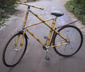

  17. kevinkrg6
    kevinkrg6 New Member
    Joined:
    Jun 3, 2011
    Messages:
    170
    Likes Received:
    It's obvious. Bamboo.
    [​IMG]
