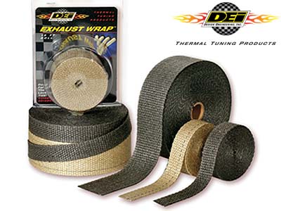

If performance isn't a priority than the classic "poopoo" pipe (available frm a number of vendors) is a simple & inexpensive solution as just length alone reduces noise considerably;
Yet if ya want the best of both worlds lol, you can take a full-length expansion chamber system w/a glasspack silencer and modify it to quiet it down as described here: http://motorbicycling.com/f3/whats-difference-20708.html as well as the after silencers (basically lawn mower mufflers) that are offered with that thought in mind, as well as the header wrap many have used ;)
