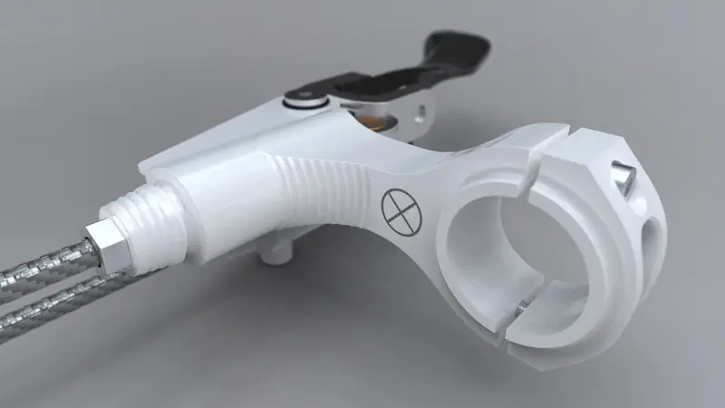

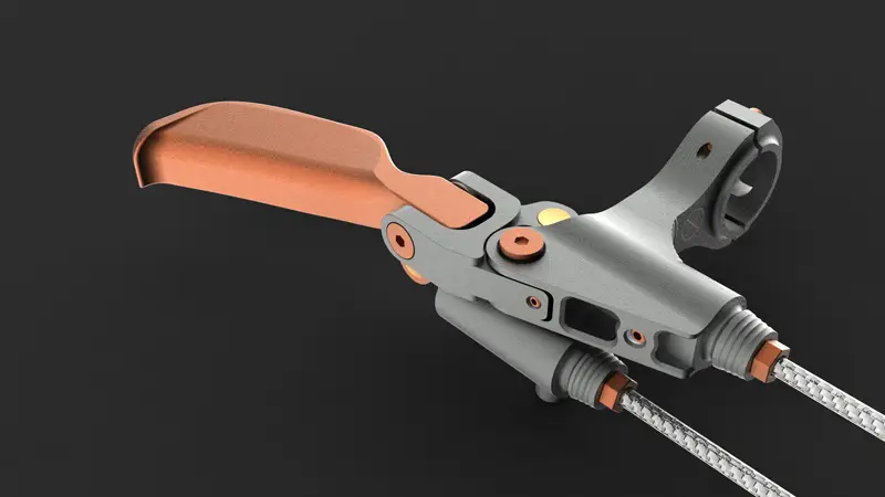

Hi all again,
My project is coming to a close pretty soon (7 weeks) and I'm starting to produce some images of the final product:
The X-Flow Dual Hydraulic Control System.
I can't discuss the ins and outs due to a few legalities but I can tell you it operates both brakes individually and together with one lever one one side.
Let me know what you think of the overall look.
Thanks
Oli

Oli that is a brilliant design!!! Not only from a mechanical functionality standpoint, but also from a form and fit standpoint. GOOD JOB!
Jim
