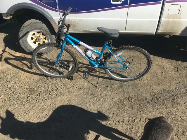

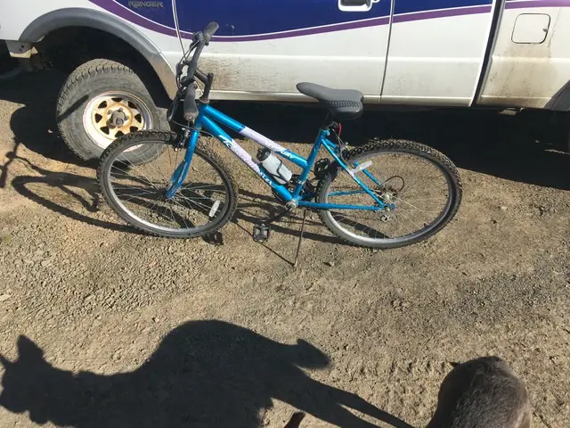

I’m going to try to post a picture of the bike I plan on using. I haven’t ever done it before so we’ll see if it works.

I’m going to try to post a picture of the bike I plan on using. I haven’t ever done it before so we’ll see if it works.View attachment 106923
We'll seeing the bike that you're starting with and the fact that you haven't built any other ones. I would certainly recommend the weed eater bike there's plenty of YouTube videos on it .you'll appreciate the simplicity and after you fiddle around with it you can try the bigger motor it's the same system and so far you had $20 into a Craigslist home lite weed eater and $10 in parts and pieces if they aren't already laying in your garage . The 79cc is $99 at harbor freight. Your Honda motors almost $300 and it ain't got nothing you need. You get the weed eater bike done by this afternoon and riding it tomorrow it was still be cheaper just to run to Walmart and get a homelite weed eater and a bicycle peg .
I may build one with the weed eater motor. We’ll see. The Honda GXH50 is a industrial style engine with a shaft output and is much different than the GX50 used on the staton kits and the like. I would be happy to use the 79 cc harbor freight motor but up here we have to stay under 51ccs if we don’t want to have to title the bike
