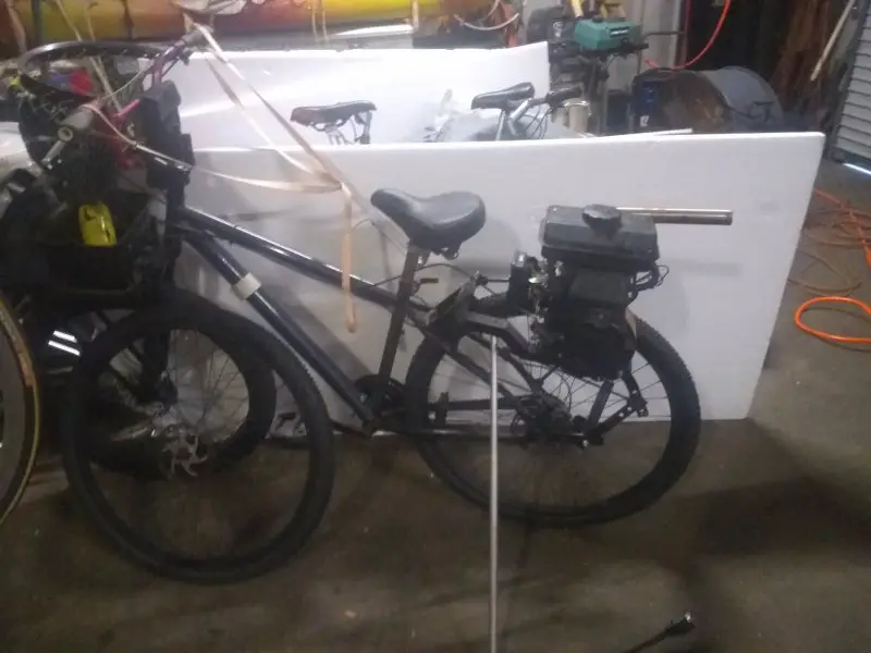

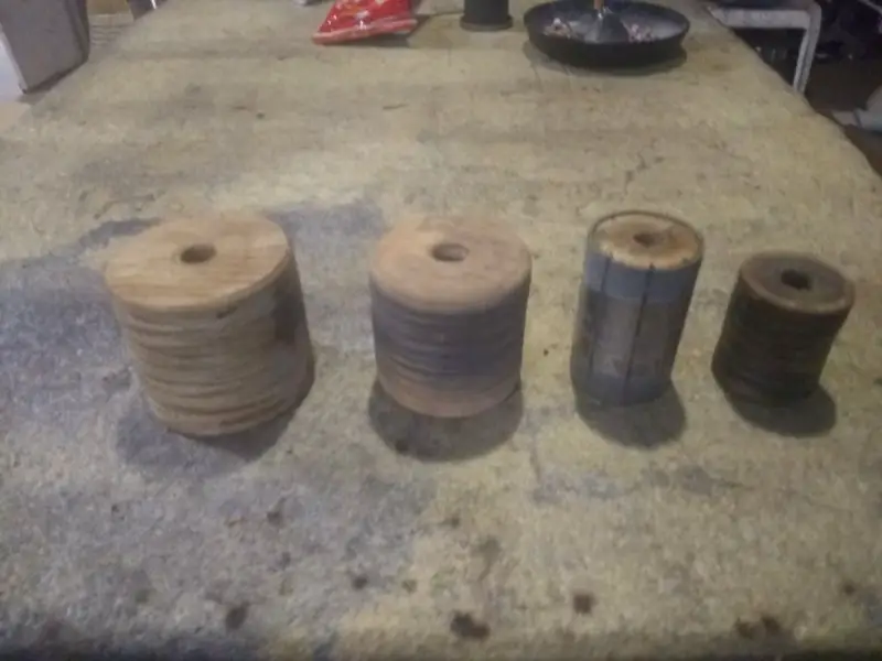

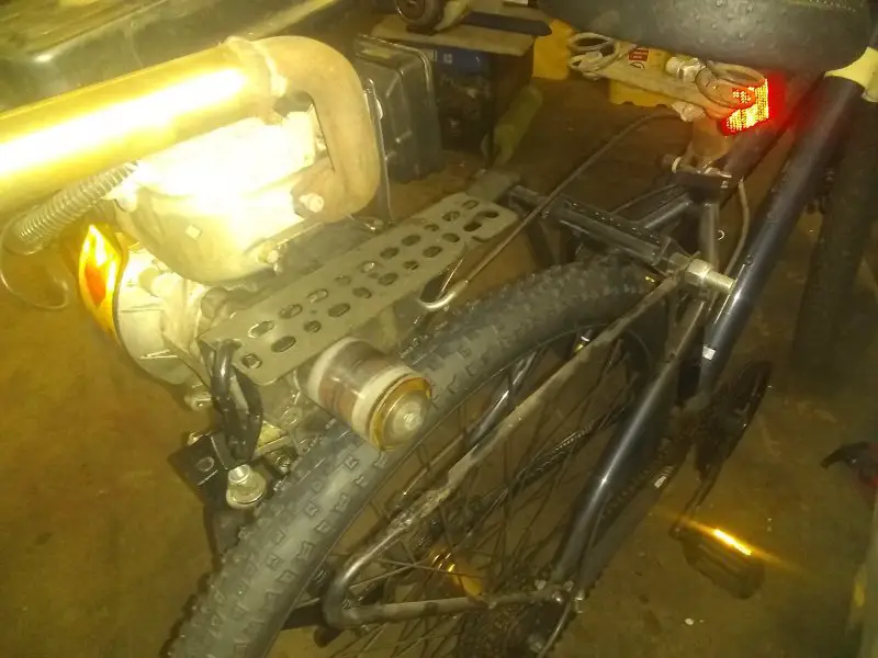

I've done a little bit of travel with the friction drive I've read through most of your post here the 79cc friction drives that I build for my friends can change drive rollers in under a minute.

Well that's really encouraging. I definitely wouldn't be disappointed with well over 100 miles a gallon! Could you send a few pictures of your motor and how it's drive system works? Thanks a lot!
I've done a little bit of travel with the friction drive I've read through most of your post here the 79cc friction drives that I build for my friends can change drive rollers in under a minute.View attachment 106846View attachment 106847View attachment 106848
Thanks a lot for the pictures! I really like the direct drive bikes like that. I love the simplicity. My one concern thou with the direct drive bikes like that where there is no support on the end of the roller is whether the pressure against the crank shaft bearing will cause premature wear and failure of the motor? have you ever had any problems with that and have you put large numbers of miles on yours that are built that way? I really like the idea of being able to just pull the bolt off and change rollers. What kind of mileage are you getting with one of the 79cc friction drives if you happen to know?
Over a hundred miles to the gallon yes we've used them a lot I used them to go touring .I've got a write-up in the friction drive section here of one of my trips the shaft coming out of the motor is 3/4 in or 5/8 in you're not putting no pressure on the bearings.
