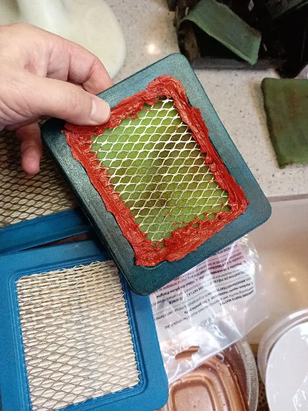

I inspected the wet yellow area on the paper air filter and it as it turns out is not gasoline but oil mist this time.
Before it was probably both gasoline from valves out of spec and breather oil spray.
The breather actually routes into the throat of the carb, between it and the air filter.
The oil mist I think should not get the paper air filter coated with oil mist. The direction should be primarily just into the carb throat.

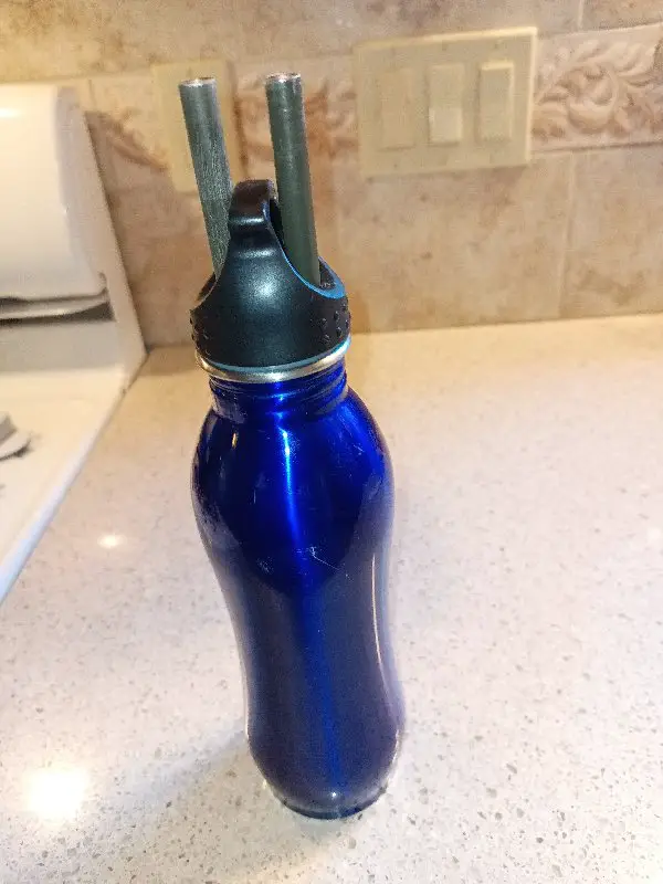

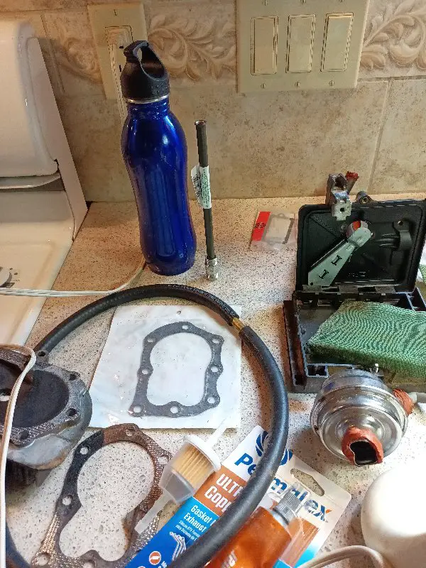

I have a stainless-steel water bottle with a plastic screw top. I have some brass tubing and rubber automotive OK for fuel / oil and high temp Copper RTV stuff to make the catch can.
I was ready to drill the cap for goes into with the metal tube going nearly to the bottom of the bottle. The goes out just a short piece of tube to have the oil stay at the bottom of the bottle and only mist out the top. Maybe some additional filter to stop the mist of oil and just let fumes by the exit of the bottle to go back into the intake.

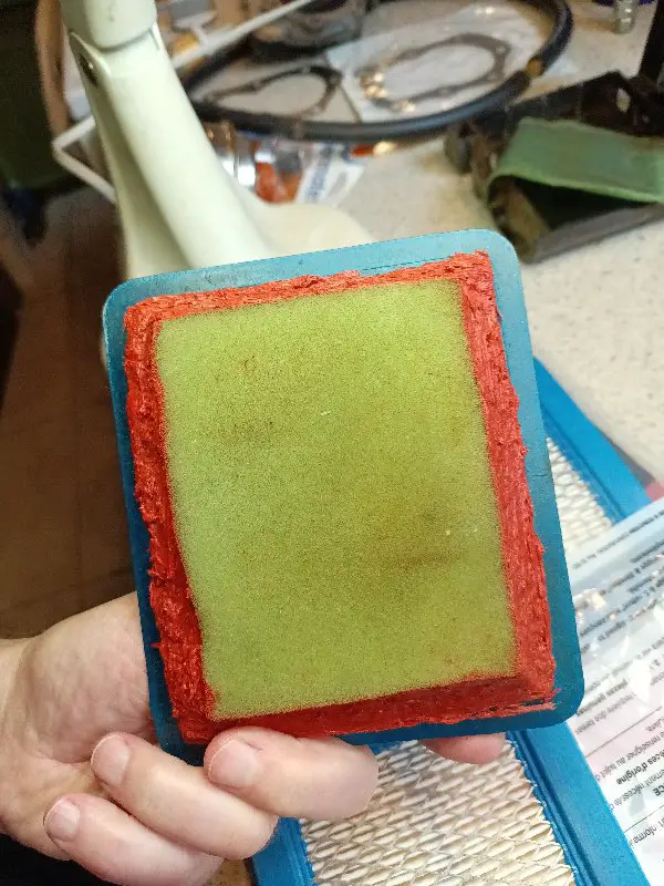

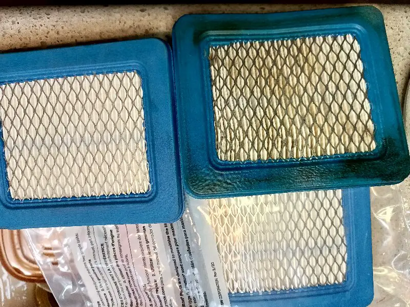

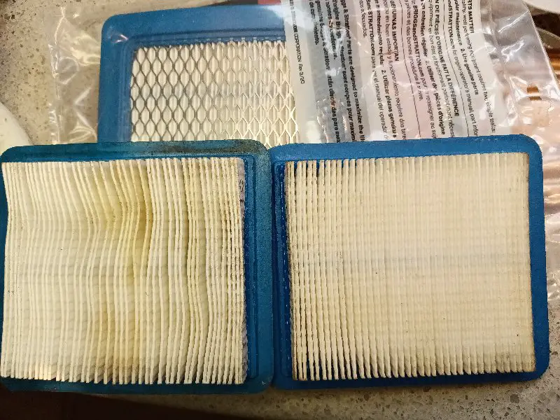

Pics of pleated paper airfilters. One still new unused in bag. One with lots of oil soaking. One other only slightly used no too bad.
At one time with valves out of timing and gasoline thrown at paper airfilter I though of saving money with special foam for a custom airfilter reusing the gasket from an old paper filter's bezel. I could clean the filter as it is foam not paper with special cleaning fluid they sold along with the special foam. Waste of time really, need a catch can!

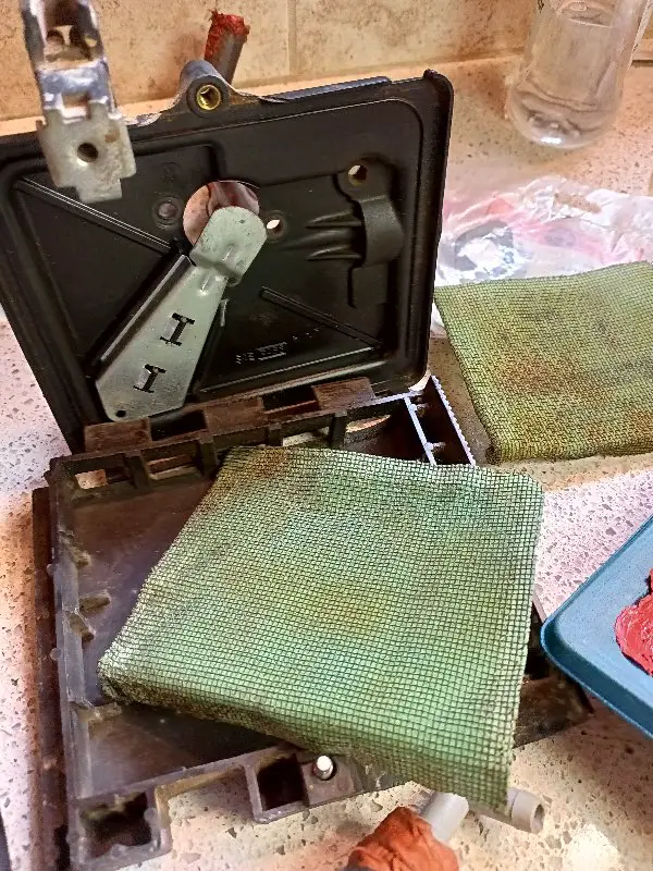

Prefilter screen with foam looks like I can clean probably with the stuff I bought for the funky foam make your own filter. I can put inside the bottle.

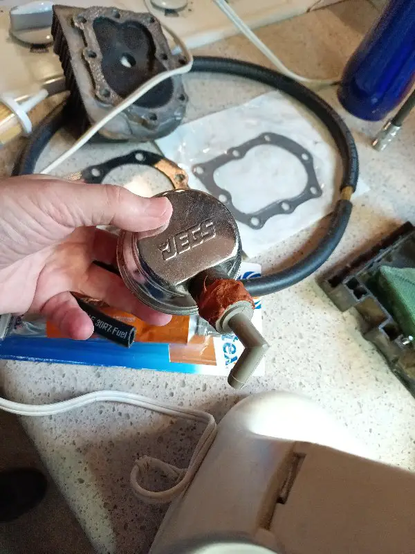

A JEGS brand PCV that has a filter screen in it but bigger than the one that mounts on the engine made by Briggs. Could use two in tandem? Still in any case need the catch can device.

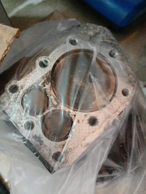

All parts getting ready to assemble.
Cleaned some of the carbon and old cylinder head gasket off.

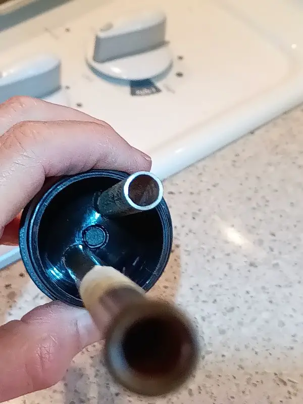

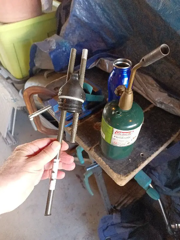

So I got the start of the catch can going. I was to drill the two holes on the cap of a metal bottle with plastic screw top. The cap I drilled or tried but just the center punch cracked the very thin plastic. Not too big an issue though. You see I took a torch to heat the steel tubes that I were to drill holes in the cap for them. Very nicely done. Just need to beef up the inside of the cap with a rubber or cork stopper and also drill and RTV in place these tubes.
Question if any of you know about torches.
The plain Bernsomatic Torch I used with a propane bottle would not light unless I use a gas burner on a stove to place the end of the torch tip with the gas on. A match or a lighter just gets blown out. Even on the lowest setting I could have on the torch the same thing happened.
I did find the little filter of some sort before the tip on the end of the tube coming from the torch valve had a blackened look. I cleaned it off and saw the yellow screen of sorts. This made no difference. A full propane bottle or one near empty both would light and work fine but would need a gas flame of the stove top, not a match spark, or lighter.

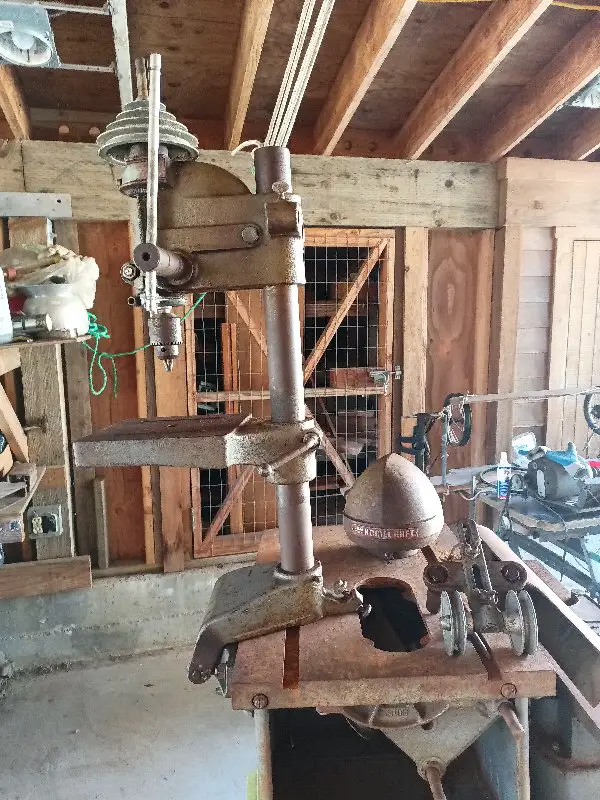

Now that I have the Drill Press I have part of a combo old Rockwell Delta Homecraft from way back 1952 mfr year, I thought I would clean up and use the Sander as well. The Saw Table and 4" Jointer, I will just not bother with right now.
I tried to find out where the pulley went to use for the Sander. The circular blade from the Saw Table gets remove to allow a pulley on one end of a shaft that has another pulley going to the motor. The with the Circular Table Saw Blade removed I need the pulley to connect to the Sander.
I looked at the Jointer that has a pulley on it and it would fit just right on the Sander. Both Jointer and Sander are not used at the same time, so I attempted to remove the pulley from the Jointer.
Oh, what a pita! I found that the shaft that the pulley is on the Jointer had a mushroomed end. That would not allow the pulley to come off. Sure, I took out the set screw on the pulley, it was not properly on the flat spot on the shaft.
Nope, it was about 180 degrees opposite the flat spot on the shaft. Who did that.? Additionally, I could see if the pulley was put flipped around as opposed to the way it was, the flat spot could align with the set screw. It only allows half the set screw to align with the flat spot the way it is now.
I went to using a Dremel with grinder and cutter wheel to get the mushroomed end of the shaft cleaned off. So then it then could move about a 16th of an inch more toward being able to come off. Gee, oh well.
There is something else, probably the flat spot or whatever that marred the shaft and I spent so much time already, I am about to give up and just leave the pulley on that shaft and buy another for the Sander operation.
I could see where I have put my small flywheel puller to help remove the pulley. But you know I will probably be at the hardware store to find a pulley I could use. Maybe I must go out of town or online, but oh well.

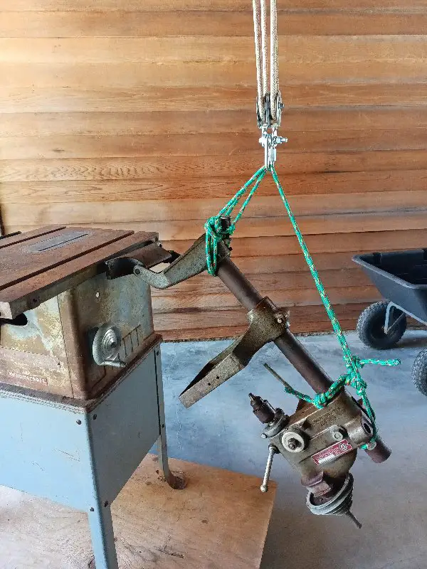

Tomorrow I can just get the Drill Press set up by using my hoist to hold it in place to bolt onto the Rockwell Delta Homecraft Combo. Then onto making the catch can.

Then onto finishing drilling holes in a piece of closet hanger rod wood for the two tubes for the catch can bottle. I will glue that into the bottom of the bottle cap.
