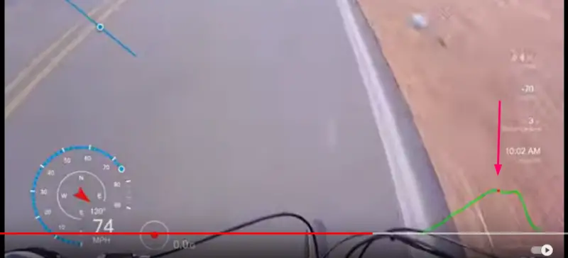

I'm curious how you calculated the speed?

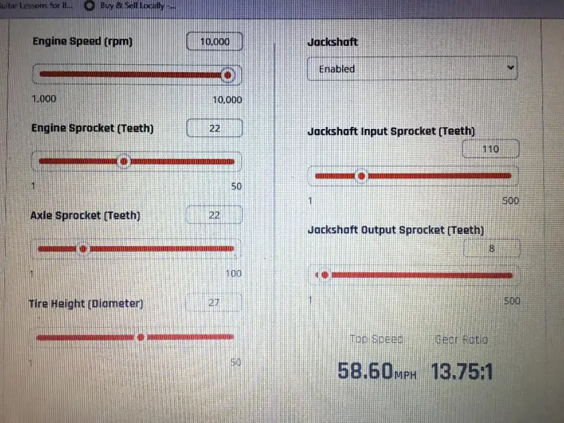

I have an Answer! Math below comes out to 79.77 now in my video it says top speed of 75mph on GPS speed tracker. The 2 are pretty close to each other in end! math is in perfect world conditions and GPS is real time with environmental and situational effects on bike! get what I mean! but they come out close so you can test if one is bs or not is the point! many edit videos and stuff to make it look faster then the bike can mathematically go even! but math in this case actually even out preforms the post speed I showed on the gps! Basically to show it's not a bs video!
Engine Transmission gearing is (82:20T) 4.1to1 Ratio
Engine Rpm was 10,974
10,974 / 4.1= Output: 2,676.5 RPM
Chain Pinion (8t) to rear sprocket(22t) 2.75 to 1 Ratio
2676.5 / 2.75 = Output:= 973.27
27.5inch wheel is = 12.2rpm per 1 mph
973.27 / 12.2 = 79.77
Giving Us A: Top Speed Of ( 79.77mph)
Venice Motor Bikes
Mar 20, 2008
7,266
1,797
Los Angeles, CA.
Also.... look close at the gear ratio charts you have posted... 30t / 60t gears are not 1:3 ratio!! (that's 2:1 ratio).
Think about it... the 30t gear has to spin 2X for the 60t gear to spin 1X (that's 2:1)
In conclusion... your math is all wrong.
You should try using a good GPS speed app (on your phone) instead. ;)

He also says in the comments that he's going down a slight hill. There's a fairly long grade in Strawberry Plains Tennessee around 9 miles. I've got up to 50+ mph on it with a 33cc 4 stroke engine. There comes a point the engine is no longer contributing and gravity takes over.
