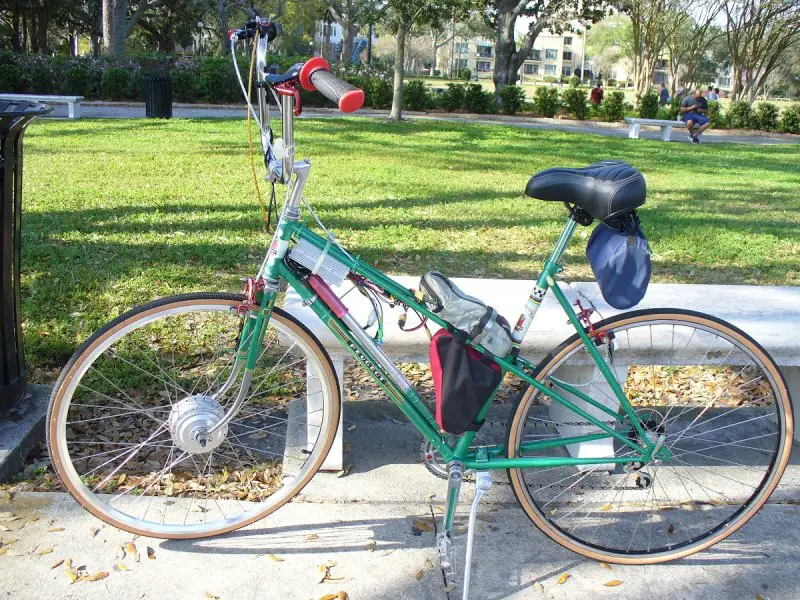

As you can see, I have the controller perched on top of the battery and held in place by the same two worm clamps that hold the battery to the rack

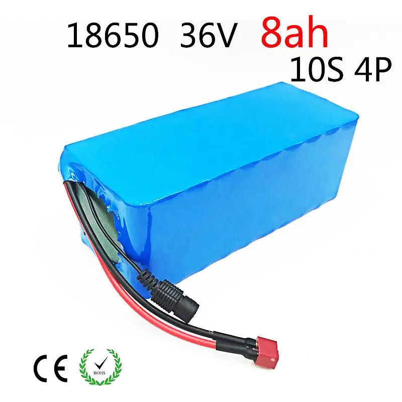

Some with 40 18650 cells to a pack are undercutting the solid battery cases in prices- maybe we'll see greater price competition and lowering of prices - at any rate it looks like we're suddenly getting more choice.
Heres the cheapest of the 40 cell lot:
https://www.ebay.com/itm/36V-Li-ion-Battery-8AH-36V-Rechargeable-Bicycle-500W-E-Bike-Electric-Li-ion/253985601621?_trkparms=aid=888007&algo=DISC.MBE&ao=1&asc=20131227121020&meid=35a52072cdbb471084c49ea9d274507e&pid=100009&rk=1&rkt=1&sd=273642008405&itm=253985601621&_trksid=p2047675.c100009.m1982
I see basically the same 40 cell package being advertised from $98 to $138, and the ah amp numbers very wildly- I'm not sure if it's differences in advertising claims and/or price schemes- so "Caveat Emptor" - Let The Buyer Beware!

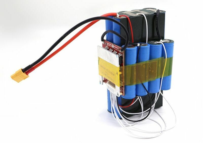

Just another short follow-up- I was first wondering about these 40 cell packs- 10 cells in a series wired four parallel grouping, because they have different amperage claims. Now looking more carefully, I see that the ads DO contain the ah rating for the cells- so that is the difference. The $98 pack does not seem as cost effective comparing to the Hover board packs hen one sees that the cells are rated at only 2 ah while the Hover packs claim 4.4. (I suggest you read the thread "The Darn Spot Weld Wall" for some interesting comments by Junglepig on the possibly false claims of 18650 cells by sellers.
Among the 40 pack cells- claiming between 8 ah to 12.8 ah, the ah rating for the individual cells is in fact given in the ads, if you look closely. The cells vary in amps and so the claims of ah in the pack vary. It's tough to tell if the claims are in fact accurate, but probably vary in a relative way at least. 10 ah packs claim 2.6ah individual cells, the 12 ah packs claim 3,2 ah individual cells. Junglepig says on the other thread that most claims over 3.0 ah are exaggerated, so Caveat Emptor. Anyway- if I bought one of these, I may look for cells higher than the 2.0ah of the cheaper $98 pack- the difference between 10 ah and 12ah packs might not actually be 2 amps if you believe Junglepig, and he sounds like he's hip to the 18650 scene

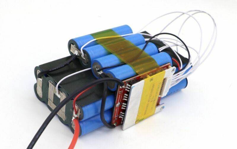

Well. I've been slightly confused- I thought the Hoveboard balancing scooter packs had ten cells apiece- but according to these photos now appearing in an ad- apparently they have 20 cells:
(The yellow connectors on the end are T60 female connectors)
And so their relationship to the other cell packs and bike batteries is different- the 40 cell packs are actually similar to two of the hoverboard packs- not 4 of them. The amperage claim specs for the individual cells is the difference. they almost always describe the Hover packs as 4.4- so two of them is an 8.8 battery otherwise, of 40 cells. I think I should then be getting more miles from them.

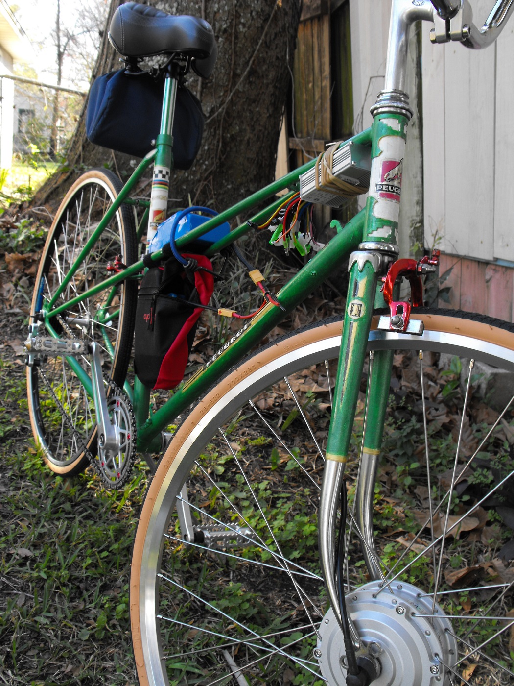

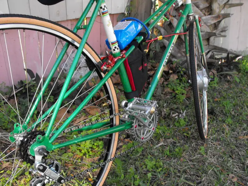

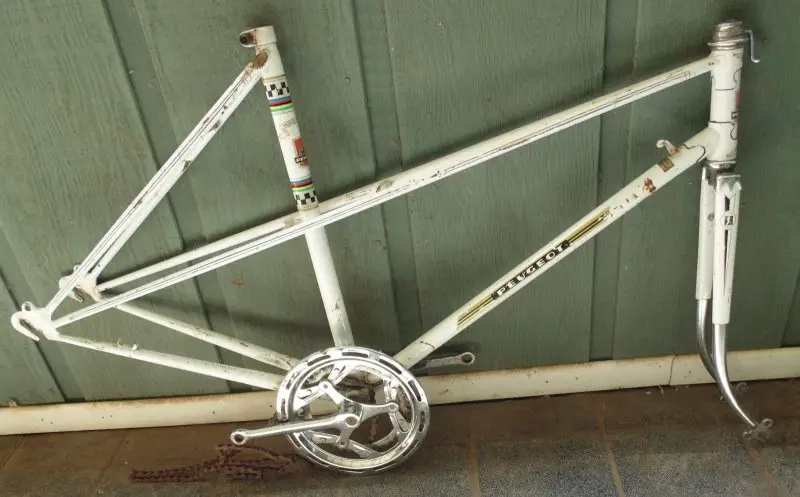

I've made some decisions now on the Peugeot mixte frame I'm fitting a 36v 250 watt hub motor to. I'm using the hoverboard battery packs- probably two of them (20 18650 cells apiece wired 2x 10 series each for a total of 40 cells, yet I have the option of adding one or two more packs or only using one).

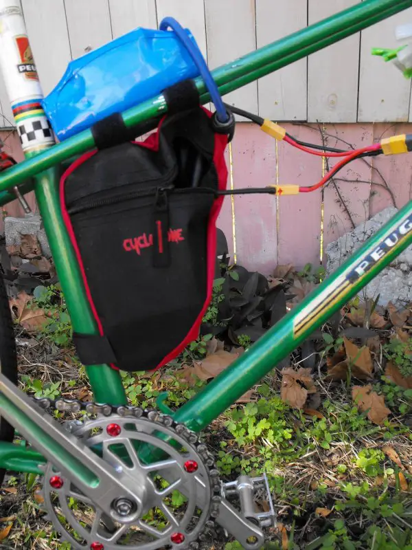

So anyway- one pack fits in a nylon triangle frame pack tucked very nicely between the pedals and another will latch onto the mixte rails above it-the controller will affix under the rails. The T60 parallel connector reaches both battery packs from here and a short reach then to the controller.
So this battery arrangement leaves me FULL carry potential- with both a front basket and saddlebag baskets and rack top for goodies I may want to bring home. I originally was going to put both battery packs and the controller at the bottom of a front basket and that would still leave 7 inches of depth on top of that. This arrangement will keep the battery weight (2 or 4 lbs with 1 or 2 packs) lower in the center of gravity on the bike The controller will also be fixed to the rail with a worm clamp or two- and not the rubber band shown here,
Pictures may say it best- Not rushing the process but hope to have running in a month or two. Tires are 700 x 28 mm, the Stronglight 93 is an upgrade from a steel cottered original crank, so this is built with lightness in mind- Projecting 16-18mph under it's own power with any amount of pedal assist I choose to give-, and a range of 10-13 miles. (I went out on the GT electric yesterday and after hibernating felt sluggish, so I let it take me more than otherwise)
p6-jpg.944982
The paint needs some further touching and clear coat I think and is a blend of Folk Art green and another acrylic green. Here's what the frame looked like when I got it. I just had to GO GREEN. There's a green one on ebay I saw last night if you're interested,

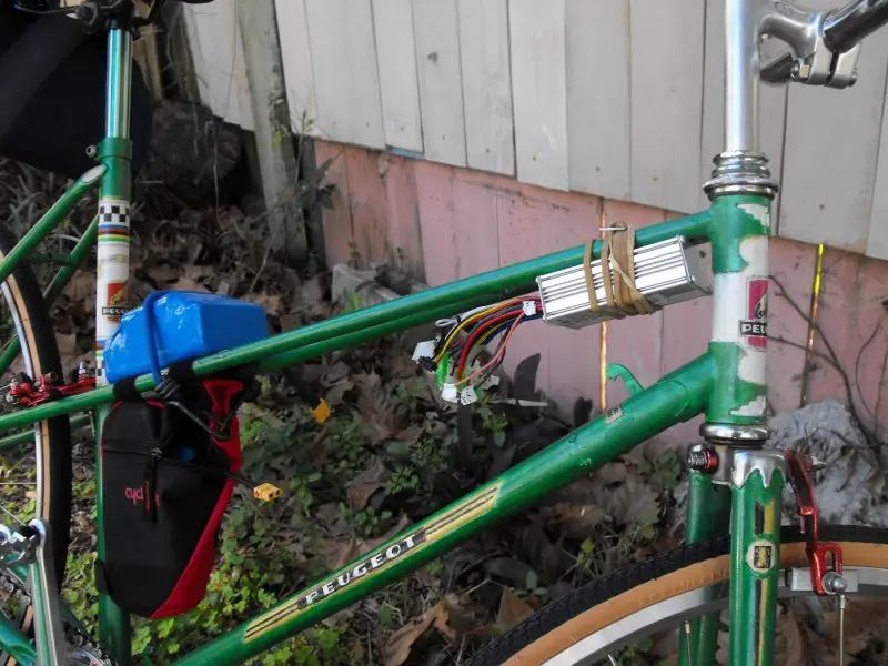

Anyway as far as my own project has gone- I had some problem with the Peugeot controller, and got the wheel running with the turn of a key, but could never get the three pin- black green, and red- throttle control to have an effect. Apparently it functions at a low voltage level of about 5v, like a car relay I assume- to open and regulate a line to the wheel with the varying 0 to 42 voltage.
The controllers are a bit of a can of worms if purchased outside of kits as this was, and complicated by the fact that I'd bought it a year or two ago. The harness I put together to replace the cut 9 pin line apparently worked, but the specific wires and their functions from the controller were baffling- different on almost every one I studied on ebay as a replacement and I was getting quite frustrated. A couple of questions I tried to ask vendors went unanswered, and the connectors appear to be in a manufacturing state of flux- generally becoming smaller.
Long story short- I ended up getting another controller from ebiking- who I bought the kit from on the 500 watt silver GT step through bike. I also got an LED display from them I knew would then plug in and turn it all on- mostly to eliminate that factor, which was confusion on aftermarket Chinese controllers- but then I opted not to use the key throttle grips that were displaying the Peugeot's voltage in red block letter- Tant pis! too bad. Anyway- I'm familiar with the 4 LED dot system, so off I go.
Now I have a 500 watt controller-larger and heavier- but DEFINITELY stronger- drawing 22 amps instead of 13. And the wheel now spins much faster than when I did when I had it going under key, but not throttle-
So with a little bit work= I've had the Peugeot Mixte out to test a short bit- with this stronger controller- it's almost as fast as the other bike with the better silver fish 4ike battery, but surprisingly a little bit louder for some reason. This 250 watt hub motor whirrs louder- it might be the 500 watt controller I suppose, but it's loud under any amount of throttle (though not like a China Girl!) Once again I found the little Stronglight 39 chain ring insufficient and was overspinning at full throttle- I'll put a 42 crank set on, but I think you can go 45 or 47 if you really aren't granny aged like myself. I'd probably keep both rings and a front shifter if I was in my prime, but not all that need in flat Florida. I want to go out again- the test was short- 2 or 3 miles and just sorting out the bike frame and wheels for the first time too.
There was great weather yesterday and I took the silver bike out and down to the river- got rained on a bit and came back- and then out again an hour or so later when it cleared again. I figured maybe I did 10 or 12 miles total- much of it riding much like a bike- only "pedaling" while the motor does most of the work- so I'm actually getting a mild work-out I can control, and I find the experience very satisfying.
Two of the four LED indicators were still lit at the end with the larger battery starting it's second year.

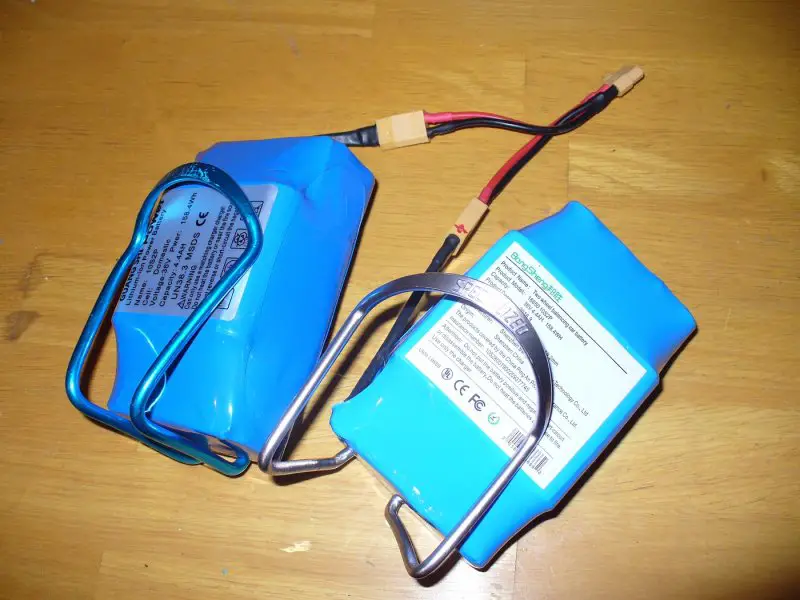

I've been playing with bottle cages and with a little bending- of the cheap from China cages (about $2 each) the 18650 Hoverboard packs fit in pretty well- With another strap bungee or plastic ties they would probably work well two in a series on a more modern frame with two sets of bottle braze-ons.
like this Lotus for instance:
https://www.ebay.com/itm/Lotus-3000...-Fork-21-Tange-/254153145080?oid=254109252329

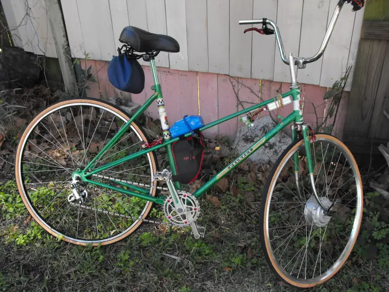

And so with a controller in a triangle frame bag and two hoverboard packs in bottle cages for a range of 10 or 12 miles it's possible to have most of a kit inside the main frame diamond.
Excellent results - well almost
I took the Peugeot mixte ot for coffee at the usual Starbucks- normally a little more than 6 miles round trip- and did a bit of random lollygagging on the way back-
I was going to take a longer route, but the crank was ticking against the kickstand, and when I stopped to check it out, I found the crankset loose- the fixed cup had begun to loosen- so I cut the long way home shorter for that reason.
I also had not changed the Stronglight 93 39 chainwheel yet, so when this baby gets up to speed- must be about 18-20, I can't add any pedal assist to the equation- in fact then almost the whole trip was under the motor's own power- pedal assist extremely minimal.
I'm going to invest in a cheap electronic speedo- if you get a LCD display with the kit or option one later- speed sensors in the motor give you all the readouts on that- speed top speed, distance etc and very accurately I imagine.
So anyway, I got home- an estimated trip of between 7 and 8 miles almost all under motor power, with three of the four LED indicators lit except under acceleration when that was dropping to two. So that was using two Hoverboard battery packs- 2 pounds each- 20 cells apiece and an ebiking 22 amp 500 watt controller.
I was loving every minute of it- just like good ole bike riding, but I won't have cramps for most of the night and I can put as much effort into it all as I desire.
