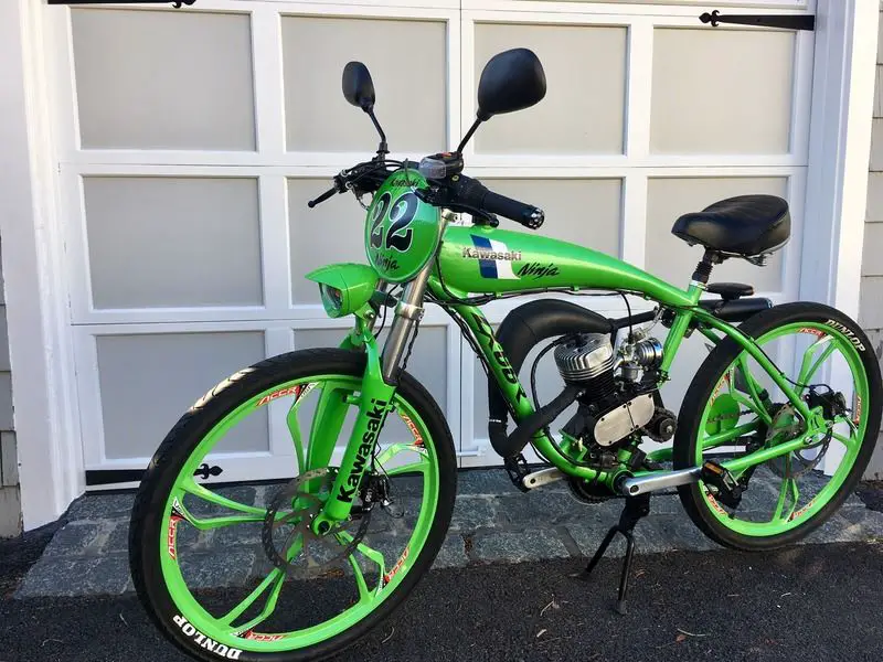

I wasn't referring to the headlight, I am referring to the Paint.
Put your sun glasses on before looking at picts, LOL. I should be seen at least.
Nothing too special about it I guess but it was a fast build. Kawasaki Ninja tribute Bike.
Triple Tree Fork
Front Shocks
60cc 2 stroke HT
GT2 a frame with the new larger tank/ 3.7Liter (Its way more prominent) and I like the new look!
Electric Green. Paint with Sublime Rims
Custom Headlight with chrome brackets
Duluth Cycle Chain Tensioner going on tonight?
Custom Tank Decals
Chrome spiral wire wrap
Custom Junction box
41 chain
Aluminum Mag wheels
41 tooth sprocket
Squeeze Brakes rear/ Disc brake upfront
Ill order a black expansion chamber and port it after break-in
Over and out
-Zip-

a couple more shots of the glow green special.

Very nice! Looks like a blast. I considered painting my bike Orange for visibility but I couldn't resist blue, my favorite color.
It looks fast which is good. I have an extra 2000 lumen 12v headlight I could send you for $12 shipped. It lights up acres at night. I'm using one on my bike.
Hey ultralight thanks big time and the offer for the light, I don't want to go the 12v route with the big battery and all. On this one I converted the motorcycle headlight guts to LED and have it stuffed with double AAs its pretty bright. Thanks for the generous offer though! zpt

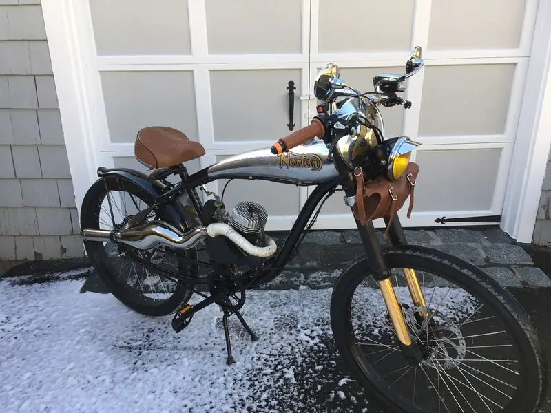

I like it, but I'm partial to green. Here is Kawi I built last year. Also did a Norton, and Honda RR tribute.
speedracer wow...wow, super nice builds. I am a green lover too. I have a Sublime 2015 Hemi challenger and the thing gets the looks. Im going to do a Suzuki tribute next, just collecting parts now. Im trying to decide on a color.
