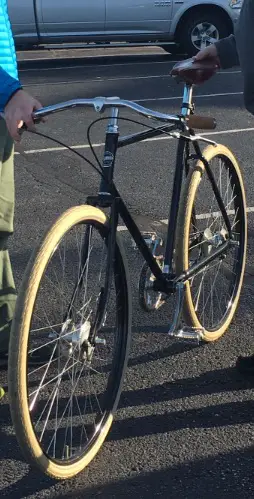

I've spent a bunch of early mornings over coffee and late nights when the house gets quiet to go through this thread and update the photo links. I think I've got them all but could be wrong. None the less, photo-what's-it is no more in this thread. Hooray for this site and the admins for photo hosting! Reading some of my posts to get an idea of what the pics should be I noticed how often I mention that I won't have time or haven't had time to work on my build. In retrospect I think I have been simply expressing my desire for more time away from responsibilities. Not too unusual I would guess but maybe a little whinny. Well I'm not going to get to work.... Just kidding.
I did recently get an early Christmas gift from my wife that I hope will improve the performance of this and any future builds. I've been wanting a Pashley Guv'nor for quite a while and one came up on the Chicago CL. The plan is to burn off a few pounds and then my Villiers won't need to haul so much of a load!

Lovely bike Harold! Though this forum is dedicated to "motorized" biking I suspect many if not most just love bicycles. I have one motorized bike that I often pedal drive at a leisurely pace. & a custom built, full suspension bicycle that I can keep up a good pace on...plus other bicycles that I just like. I've a 80's era Cannondale mountain bike that I modified to a fixie that is fun too. I use to buy very lightweight & expensive road bikes, but decided that it was better, cheaper and healthier to take off 10 pounds of fat, while adding one pound of muscle mass to myself & enjoy the bikes I had to feel much lighter. I think you're making a very wise New Years decision with an early Christmas present & revealing to others a real performance boosting accessory for their moto biking. Ride fast without hauling *#! Rick C.

Thanks Rick. As usual you're right on the money. I had finally resigned myself to not being the same type of rider that I had been so in 2012 I sold my steel Serotta and lightweight bits and pieces. It was hard to not see myself as a hardcore roadie anymore but my PayPal account looked good and that payed for a lot of previous builds. Unfortunately I'm now much fatter than my account ever was! I know I can drop a few but I know myself and it needs to be fun to happen!
