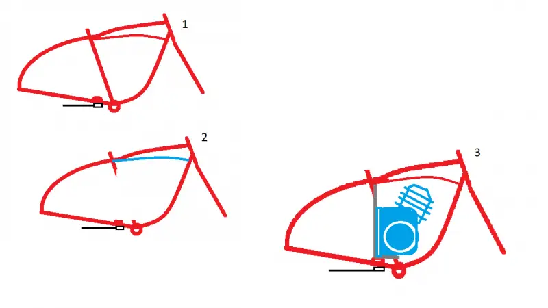

....sooooooo as I'm currently building/destroying the Cranbrook for the Lifan 97cc engine, I did end up getting a shiny new 212 Hemi as a back-up!- Upon looking at the project, some slight butchery of the frame would be necessary for the 212- at least how I want to apply it. My plan, if I go 212,, is to cut the seat-tube and replace it with an engine mount plate, tying the lose ends of the seat tube at the top of the frame and at the bottom bracket.
...but I'll cross that bridge only if if I have to. Right now, all my eggs are in the "Lifan 97cc Basket".
