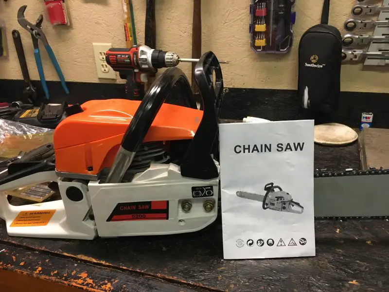

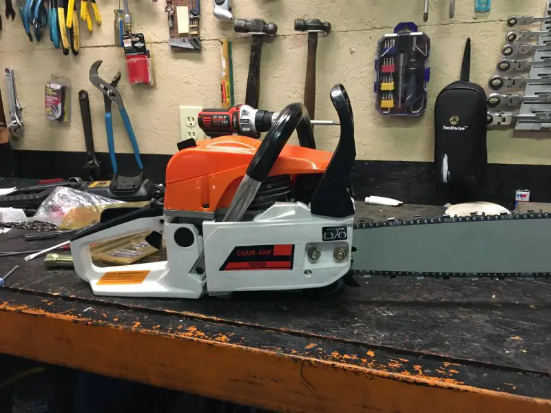

I’ve been seeing a lot of the Chinese chainsaws on eBay so I did some YouTube searches and found several videos, after watching a few I decided to do a test myself. The saw I ordered is listed as a 62cc 20” bar that looks to be a STIHL copy. I searched every saw in the 62cc size and bought the lowest price one I could find, more info to come.
The saw came in Saturday while we were out of town, I opened it last night and guess what? It’s not a 62cc engine it’s a 52cc, you can see it on the cylinder casting near the base. I kinda figured the saw would be no different than the bike engine that’s why I ordered the lowest cost saw listed. I’ll get it assembled and see how it runs when it stops raining here.
Here’s a couple of pictures.

This saw cuts fairly well, the only thing I'm going to do is replace the chain with a good Stihl or Oregon. The chain that came with it is a Carlton that seems to be light duty.
Parts for this saw are low priced on eBay, a carb is less than $10, at that price why rebuild it. A coil is $6-$8. I have learned that the sellers use the Chinese displacement game on saws like they do on bike engines, from what I've found on the net they may advertise a saw as a 58cc, 62cc or 75cc but all are 52cc. I removed the muffler and used a zip tie through the port and raised the piston to mark the back of it, mine is a 52cc.

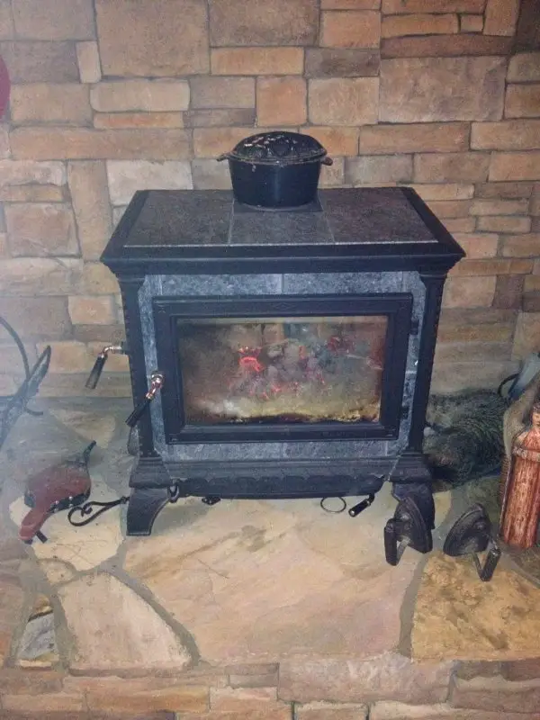

Kind of funny, but jacked up my house in 1984. Had a basement dug, block work done. New kitchen entry built by me, so first year barrel stove. Next year built a wood furnace, had 18 heat tubes in the top that hooked to duck work. Used it for a couple years, then not UL approved, so took it out. Had a gas unit put in and a fireplace installed in living room.
70pJMJth6zSLTS-v2d6W20pKbCRBfZU2caOibk2VZkRi3wBcV9zByJT927FfddEhfZP07eisGIEmdFaZ1vnRzcYILCKldRFRUF7DLlzzHdCI84jJExK7WNCKMNVN9qe4LP_rq3aW7U8o526JbMPevOQXO75zh2RpfHppVVJDWl8g1dAt1B0GCn6Qqsc_VPsNIGag0qVsDO5QaigT2oCb_mTWosbVP2qKrBr8E__biJAoLUB50wX6rSD0H9HS69N9zVQvE5gpTUxhPYkS1l5TDghgpiY-yYBvDttBpuTzcIR2naiPymC-R_ELCu-XiV9nBVf1WJ_aS2-XKEqYoKAwVqEFb0Yj2D9DcdIBKsIzvfADksad6hHw6AM6nbsxO-2ezsZKDHNDQRJSq56l9sp3_zsnZk4d5_ZDLrxfm9d3vFzrpetVt19xwFFfyzmjMlRL8HpXb1rReDPV-pq9nYfk1gJBg67hD5h6wA5JGLCuJzQDF2SypRMKhRRHj7Db651FU3aq7QS4jhE50x2xDNA-o7ODy4-83tDxvRBIAu2lhZ8hwHSysk35q8569F71k32zDE9bjEhJG8rdhCktsvMM_lhUeegUFRuElqpBPCEJ_rVUja_llKhIkw4wQRingEX3jmtPZu6rRyD5mWRghshfAjYAntqIExJxA4ahbGmM0LYXSjYTswJ22BM=w1250-h937-no
Me and my great grand daughter.
Like your stove, they are one of my fave-rat styles. Can you cook on it, maybe don't get hot enough? Had a small french made brick lined one at the lake cabin. ........Curt
When I built our house the local West's building material moved to a new location just after I got it dried in, they marked the heater down probably 1/3 off. I bought it and we had to move it around inside the house while I worked. I built the hearth and chimney to the specs of that heater, then in 08 had to change it. I did everything on the house, thinking back I should have hired out more, I even built the chimney. Back then you could build your own house here, now you have to hire a contractor. I bought all the permits myself, local contractors probably had something to do with it.
The soapstone heater doesn't get as hot as a plate steel heater does but retains heat longer, we can cook on the spot where the pot in the picture is sitting, that's a steel flue conversation cover, the heater can be vented from the back or the top.
The guys that built my fireplace owed me labor, for helping them a few years before, so just had to pay for materials, i should of tore the old house down. As ended up rebuilding all the walls , and roofs. The old live and learn...........Curt
