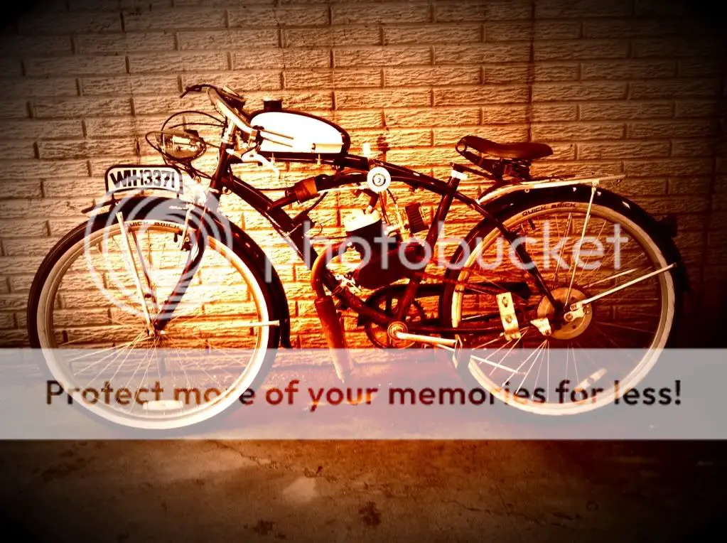

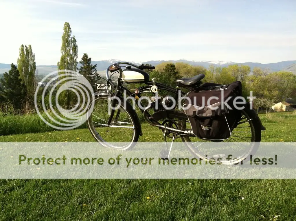

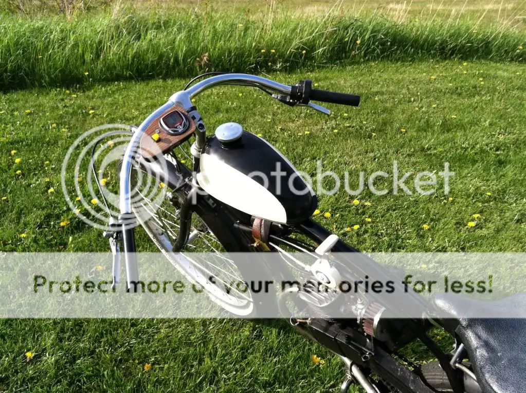

Been doing a lot of work on my bike lately. Decided to replace the rear wheel with a HD 12 gauge spoke single speed coaster hub wheel so I could use my MM sprocket adapter.
Pretty happy with that... Liked the look of wrapping the exhaust so I did that also. Painted the tank in a two tone fashion, which should add at least two miles per hour to my top speed. :) Swapped the stock spark plug wire out for the Sick Bike Parts HP wire and boot, along with NGK plug. Very noticeable difference in performance, I def recommend!! Modified my rack to sit more parallel to ground so my bags look right now. It will also give me some room for the "lay back" seat post I ordered from Pirate Cycles. Also installed a digital speedo(tried to mount it in old analog speedo housing but gave up on it for now) and got the bike up to 35.9 MPH on a flat with a little(very little!!!) head wind. Now that everything is running good, I am going to focus on some beautification's and eventually try to create my version of a BTR. My upgrade wish-list includes: Springer forks, cream quick brick tires, and possibly try to get a tank made. Took LS614's advice and removed the fenders for now. I am going to shorten the rear fender and fab up a pedestrian slicer for the front fender. I am very open to suggestions at this point, so let me know if any of you guys have any ideas for my project.

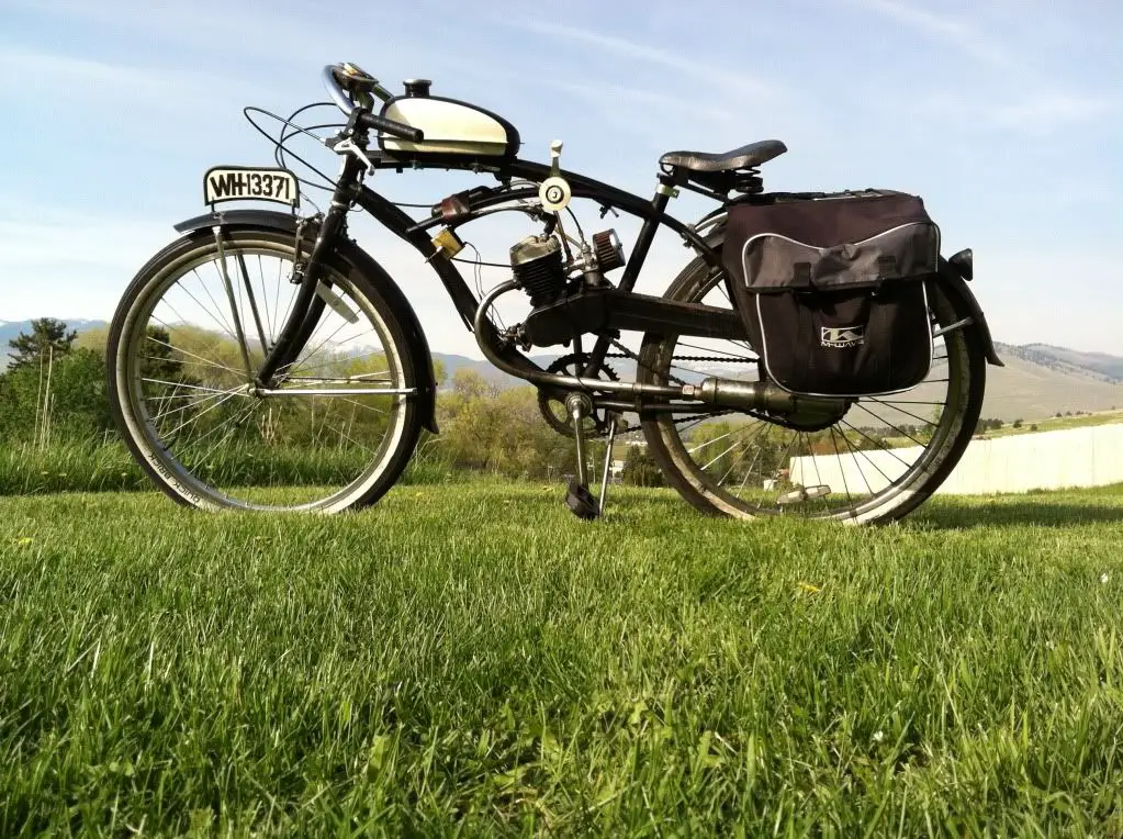

New Four Stroke, Seat, and Rear Rack!
Done with 2-strokes, decided to give a four stroke a try. So far I like it.

Looks great! Bet you're diggin that 4-stroke :D
I just put a pair of those panniers on my pedal bike last week, they are huge!
Nice work! I love the little details and great work on the woody rear rack. By the way what is the little pull start thing on the left side?

The throttle is from Sick Bike Parts, $20-25? I think and the seat is off of a Felt Hot Wheels cruiser, I got it from Motostrano for $45-50.
Thanks for the response on the parts. That seat is pretty slick looking. But looking at your prior pics, I see you dumped the layback seatpost. Is that because you can't use the layback with a hairpin seat such as the Felt Hot Wheels seat? Doesn't look like a layback would work.
You are right. When I installed the seat on the layback, the huge springs got in the way, so I tried the seat by it self and I just settled on that. I think if I didn't have the rack it would have worked, but I really like the rack and the seat sits back enough on its own.
